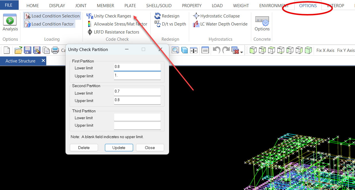

Maximum UC ration for member can be to see in post file. But same member is not found in member unity check of listing file.
R.

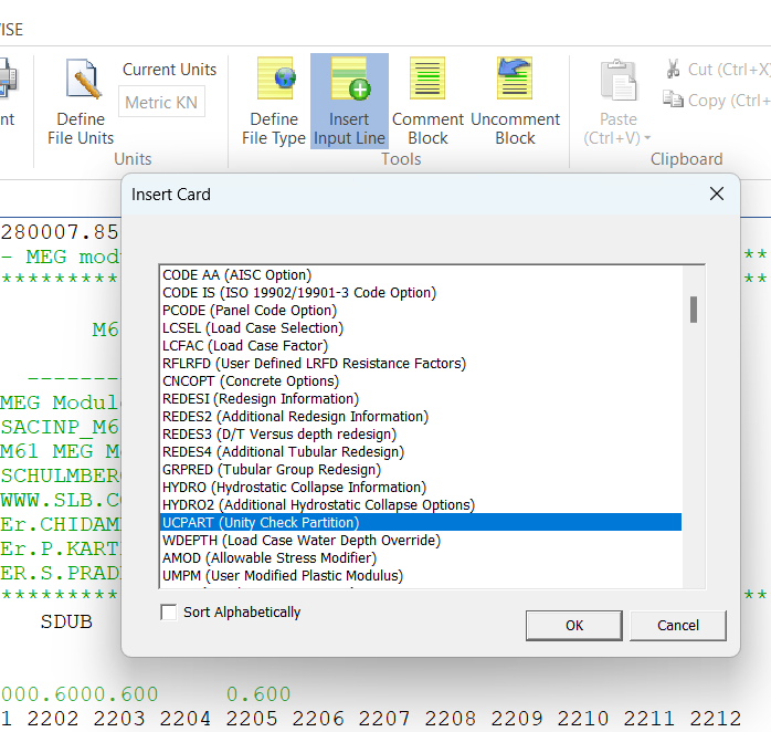

The probable reason might be the setting up of UC part command. If you have set the UC part in such a range where the actual UC are not falling, the listing file will not report them.
Since you can use the code check option directly in the SACS Basic static run as well as post processing run the UC part set in the corresponding input files shall be checked to ensure whether the correct listing file is reviewed or not.
Once you set that, then in the member unity check range summary, the information is filtered. Say, for example, see this snap.
Here, based on the UC partition input, SACS is tabularizing the in the given range of 0.8 to 1. Sometimes, users might be interested to see the UC summary of the high values only and UC ratio below a certain limit, say 0.5 or 0.6 can be ignored. That way, one can filter results among a big list. It does not have any impact on the analysis or design results.
To set the limit, either you can "insert" the command in datagen as below
A screenshot of a computer programAI-generated content may be incorrect.
Or, you can set the same from precede by checking the "option" tab and selecting the UC check range option as below.
A screenshot of a computerAI-generated content may be incorrect.
A new window will pop up and you can set the limit.
