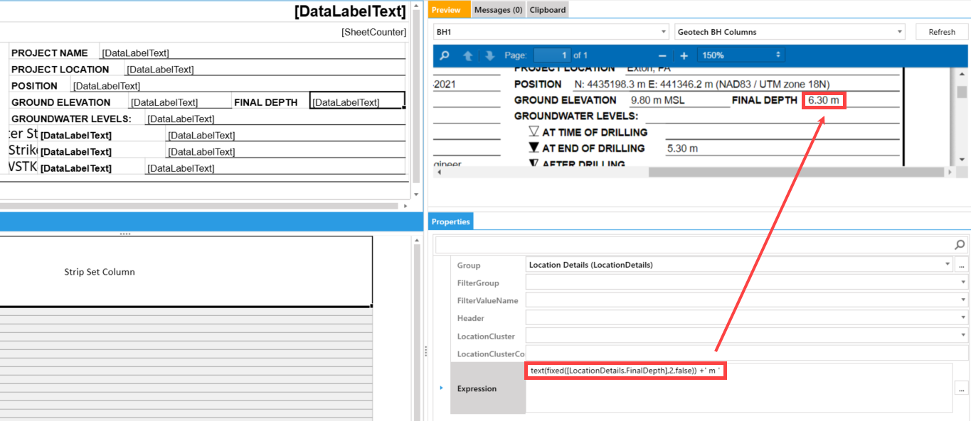

String literals are surrounded by single quotes, such as the ‘ m’ in this expression:
text(fixed([LocationDetails.FinalDepth],2,false))+' m'

In order to join strings with the + operator, values must be of text data types. Values can be converted to text data types using the text() function.
In the example above, this portion of the expression would return a numeric value:
By wrapping it in the text() function like below, the value is handled as a text value:

As seen in the example from above, the fixed() function can be used to format numerical values.
text(fixed([LocationDetails.FinalDepth],2,false))+' m '
The second argument of the fixed() function is the number of decimal places, in this case 2.
The third argument is a true/false value to indicate if thousand separators should be used for the formatted value, in this case set to false so the separators are not used.
As described above, fixed() needs to be wrapped in text() in order to join the value with other text strings.

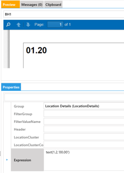

Leading/Trailing 0 Placeholder – ‘0.00’
‘0’ can be used in formatting codes to include leading or trailing 0’s. For example:
text(1.2,'00.00')

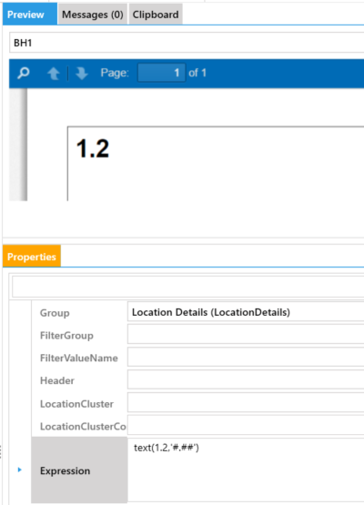

Digit Placeholder – ‘#.##’
‘#’ can be used as a digit-placeholder symbol. If the value has a digit in the position where the # code is used, it will be included in the final text string. Otherwise, it will not be included. For example:
text(1.2,'#.##')

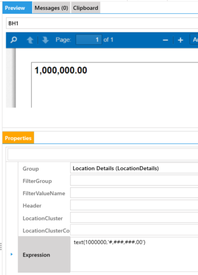

Digit-placeholders can also be used to include thousand separators in the formatted value.
To show thousand separators, a 'Digit Grouping' option and 'Digit Grouping Symbol' must be set in System>Configuration Packs>Pack Options.
For example:
text(1000000,'#,###,###.00')

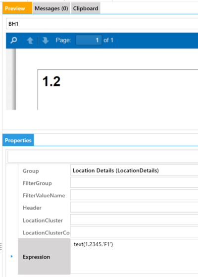

Number of Decimal Places – ‘F#’
‘F#’ can be used to show a numeric value to # number of decimal places, such as ‘F1’ or ‘F2’ for 1 or 2 decimal places. For example:
text(1.2345,'F1')

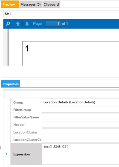

Significant Figures – ‘G#’
‘G#’ can be used to show a numeric value to # number of significant digits, such as ‘G1’ or ‘G2’ for 1 or 2 significant digits. For example:
text(1.2345,'G1')
Note that the 'G#' formatting code will omit trailing zeros after the decimal point.

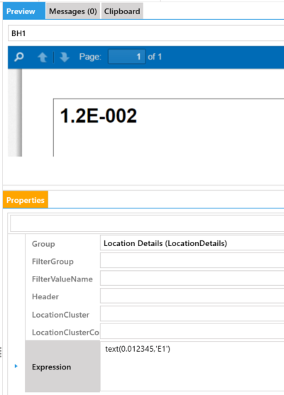

Scientific Notation – ‘E’ or ‘e’
‘E#’ can be used to show a numeric value to # number of decimal places in scientific notation. For example:
text(0.012345,'E1')
You can see the result includes some leading 0’s in the exponent by default.

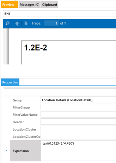

Alternatively, the ‘E’ formatting code can be combined with the # and 0 placeholder codes to further control the scientific notation format, such as to remove leading 0’s in the exponent. For example:
text(0.012345,'#.#E0')

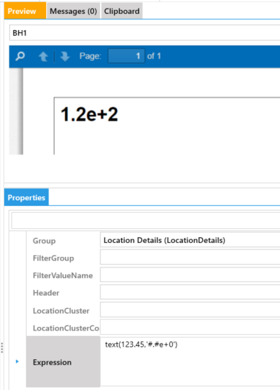

Note that ‘e’ can be used, and a ‘+’ can be used to include a plus sign in the exponent. For example:
text(123.45,'#.#e+0')

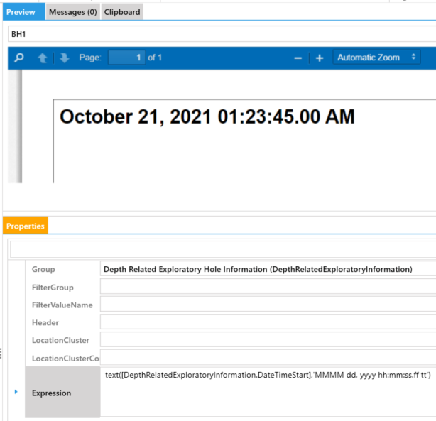

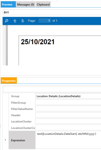

Most .NET date and time formatting codes are supported within OpenGround. For example:
text([LocationDetails.DateStart],'dd/MM/yyyy')
Or as another example:
text([DepthRelatedExploratoryInformation.DateTimeStart],'MMMM dd, yyyy hh:mm:ss.ff tt')

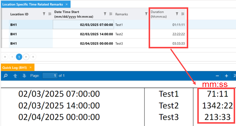

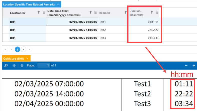

Formatting TimeSpan/Duration Headers

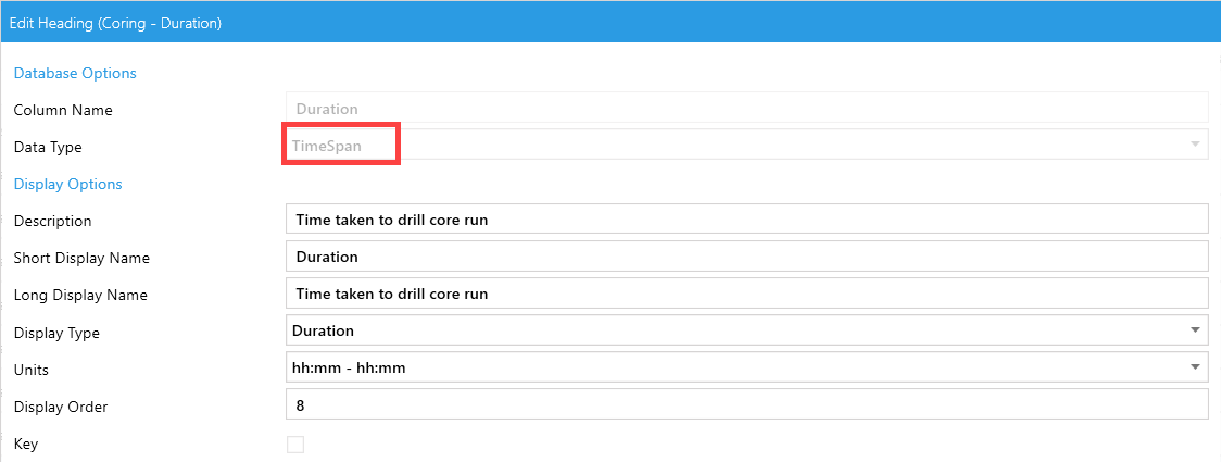

As noted above, headers with a ‘TimeSpan’ Data Type (durations) can’t currently be formatted using formatting codes. For example, you could not use the code ‘hh:mm’ to format a duration to hours:minutes formats.
TimeSpan fields are stored in milliseconds in the database. For example (assuming hh:mm units are set in the model):
When you retrieve the value from the database, such as within the text() function, it is returned in milliseconds.
An expression is needed to convert TimeSpans from milliseconds to some other format.
This expression can be used to report a TimeSpan value in hh:mm format:
text(Floor([TimeRelatedRemarksLocation.Duration]/3600000),'00')+
text(':')+
text([TimeRelatedRemarksLocation.Duration]/60000-Floor([TimeRelatedRemarksLocation.Duration]/3600000)*60,'00')
This expression can be used to report a TimeSpan value in mm:ss format:
text(Floor([TimeRelatedRemarksLocation.Duration]/60000),'00')+
text(':')+
text([TimeRelatedRemarksLocation.Duration]/1000-Floor([TimeRelatedRemarksLocation.Duration]/60000)*60,'00')
Note that you can also just reference the Header directly (instead of using an expression), which will print the value in the units used in the database. You would only need to use these expressions if you wanted to show the duration in different units than used in the database, or if you needed to use the duration within an expression for some other reason.

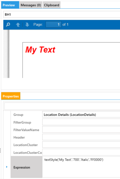

Text Styling (Font Color/Italics/Bold) Using textStyle() Function
The textStyle() function can be used to format the font color, weight (boldness), style (normal/italics) within an expression. Please see our Functions Guide for more information and examples.
textStyle() is only supported within Template expressions.
For example, this expression formats the text string to bold, italics, and red font.
textStyle('My Text','700','Italic','FF0000')

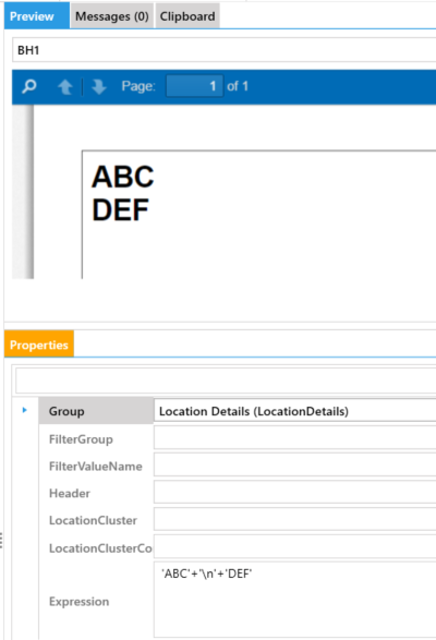

To create a new line, use the string:
'\n'
For example:
'ABC'+'\n'+'DEF'

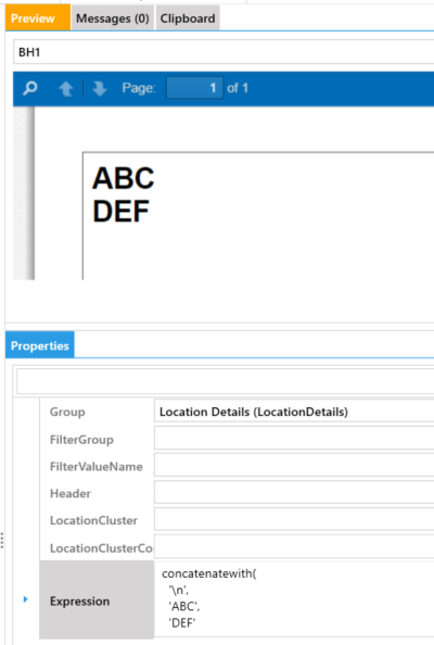

‘\n’ can also be used within functions, such as concatenatewith(). For example:
concatenatewith('\n','ABC','DEF')

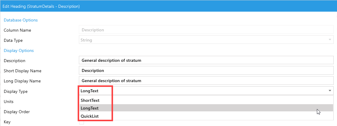

New lines can be used in Template expressions and Model Calculation expressions for LongText headers. They can’t be used for ShortText headers, which don’t support multiple lines values.

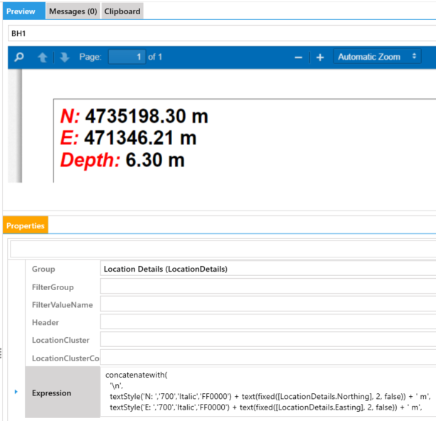

Text Formatting Example
This expression demonstrates a number of the concepts introduced above:
concatenatewith(
  '\n',
  textStyle('N: ','700','Italic','FF0000') + text(fixed([LocationDetails.Northing], 2, false)) + ' m',
  textStyle('E: ','700','Italic','FF0000') + text(fixed([LocationDetails.Easting], 2, false)) + ' m',
  textStyle('Depth: ','700','Italic','FF0000') + text([LocationDetails.FinalDepth], '0.00') + ' m'
