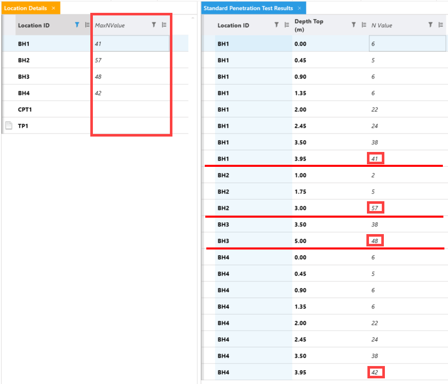

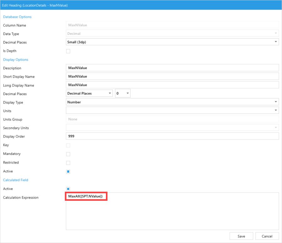

For this example, we will calculate the maximum SPT N Value for each Location.
The SPT Group is a child of LocationDetails, so we’ll need to perform this calculation in the LocationDetails Group.
To do this, we’ll add a custom calculated Header to the LocationDetails Group that uses the MaxAll() function in this expression. Note that because the expression references a Header from a child Group (rather than the same group), the [Group.Header] syntax is used:
MaxAll([SPT.NValue])
Looking at the results, we see that the maximum N Value has been calculated for each of the BH Locations that contain SPT data. No value is returned for CPT1 and TP1 where SPT’s were not performed.

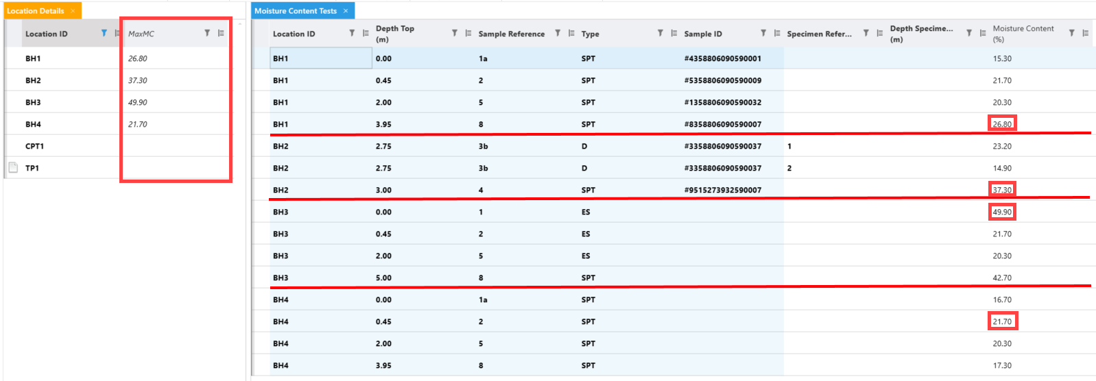

In this example, we will find the maximum Moisture Content for each Location.
The MoistureContent Group is a child of SampleInformation, which is a child of LocationDetails, making MoistureContent a “grandchild” of LocationDetails.
To do this, we’ll add a custom calculated Header to the LocationDetails Group that uses the MaxAll() function in this expression:
MaxAll([MoistureContent.MoistureContent])
Looking at the results, we see that the maximum Moisture Content has been calculated for each of the BH Locations that contain Moisture Content data. No value is returned for CPT1 and TP1 where Moisture Content tests were not performed.

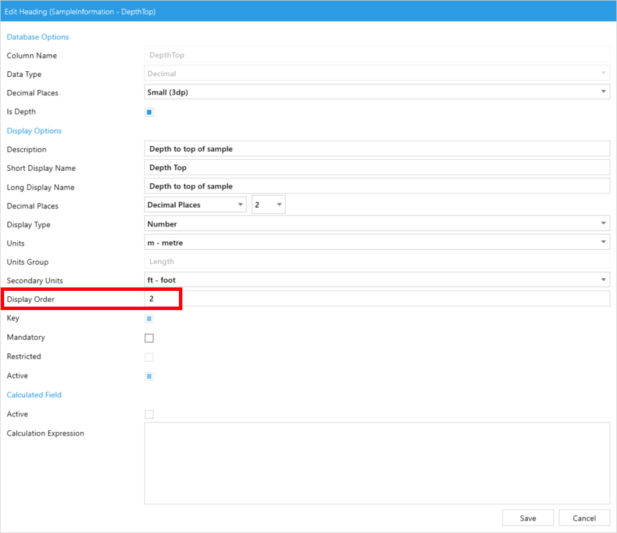

In these scenarios, the child records are ordered in ascending order by the Key Headers.
More specifically, the Key Headers are ordered based on the ‘Display Order’ defined in System>Configuration Packs>Manage Model. Many Groups have multiple Key Headers that determine this. For example, the SampleInformation Group would be ordered by LocationID (parent Key Header), then DepthTop (Display Order = 2), then by SampleReference (Display Order = 3), and so on for the rest of the Key Headers.

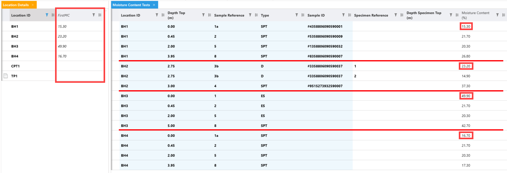

To demonstrate this, we will calculate the first Moisture Content for each Location.
To do this, we’ll add a custom calculated Header to the LocationDetails Group that uses the first() function in this expression:
first([MoistureContent.MoistureContent])
Looking at the results, we see that the first MoistureContent has been calculated for each of the BH Locations that contain Moisture Content data. No value is returned for CPT1 and TP1 where Moisture Content tests were not performed.
Note that for BH2 at 2.75 m, there are 2 records with the same parent Keys (the columns in blue from the LocationDetails and SampleInformation Groups), so the SpecimenReference is ultimately used to determine the ordering.

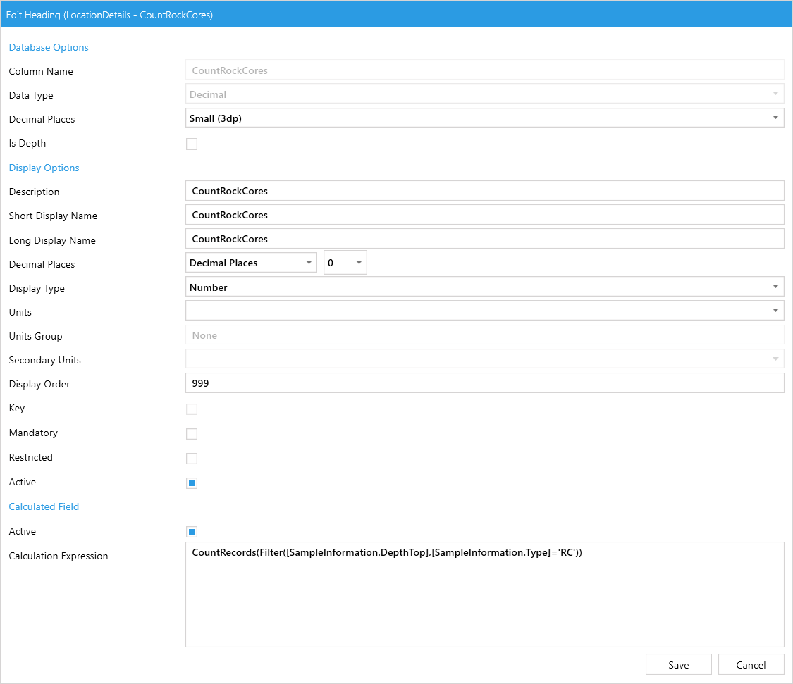

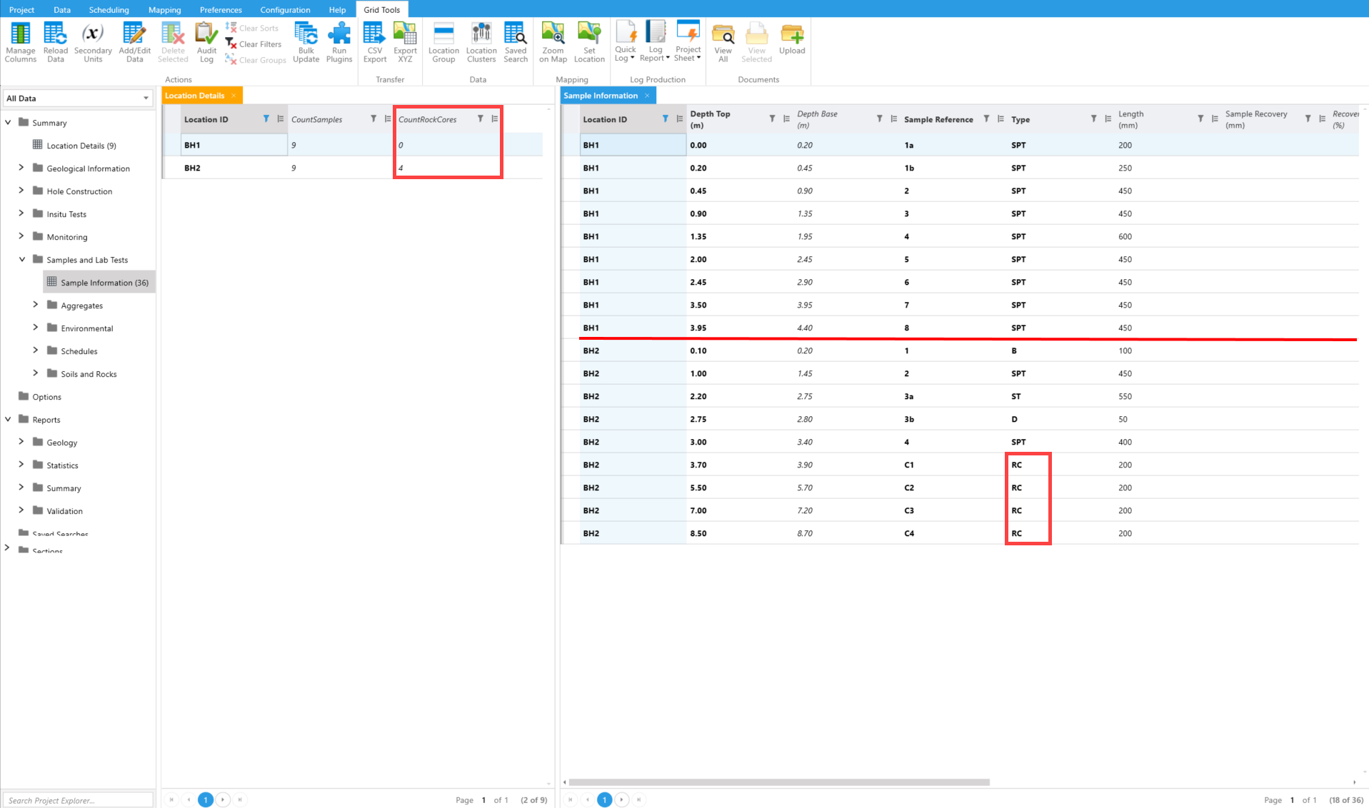

For example, here we will create a calculated header in the LocationDetails Group (named CountRockCores) that counts the number of Rock Core samples in the child SampleInformation Group.
To do this, we will use the CountRecords() function along with the Filter() function to count the number of Samples where the Type Header is ‘RC’:
CountRecords(Filter([SampleInformation.DepthTop],[SampleInformation.Type]='RC'))
Looking at the results, we see that BH2 has 4 Rock Core (RC) samples, and BH1 does not contain any Rock Cores.
