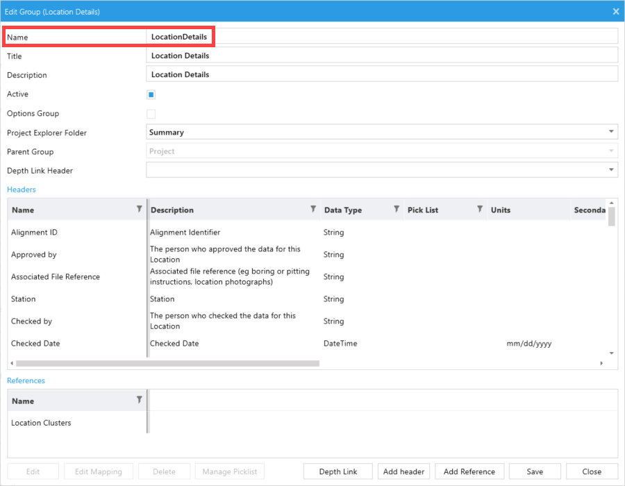

Group and Header References
Group and Header references utilize ‘database names’ rather than ‘display names’.
You can find the ‘database name’ by going to System>Configuration Packs>Manage Model.
The Group database name is the ‘Name’:

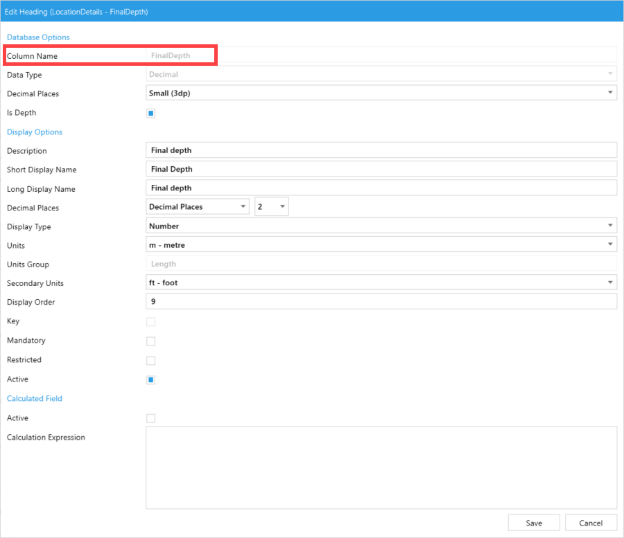

The Header database name is the ‘Column Name’:

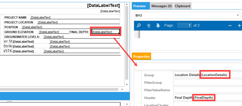

If you are working within Template Studio, most objects will include dropdowns for the Group and Header. The database names are the names in parentheses:
