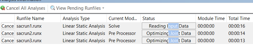

Within an analysis, let’s say you have different subdivisions. When you put the multirun, the analysis sequence is a parallel type of run. Say for example in the following snap, you can see the first run has moved from "pre processor" mode to "Solve" mode however the second and the third run are still in the pre processor mode. So, eventually, the first run will complete, and the other runs will continue and so on.
