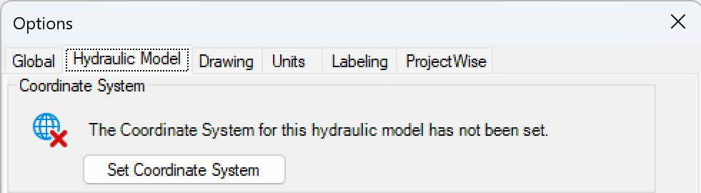

Setting the Model Coordinate System

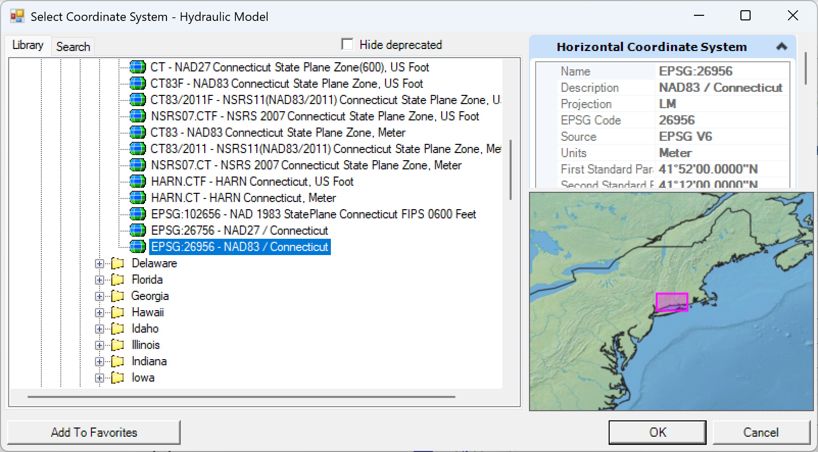

To establish the coordinate system of your hydraulic model, open the Options (in the Standalone version this is located under File > Options > Hydraulic Model), then click "Set Coordinate System".
In the dialog that appears, you can browse or search for your coordinate system using the Search tab. For example if you know the EPSG code you can search for that as well.
Click the Add to Favorites button at the bottom to add the selected coordinate system to the "Favorites" section (see top of list), as a convenient shortcut to re-select in the future (for example for other models).
Note that when you select a coordinate system a map view is shown on the right side, to help you by clarifying the region covered by that coordinate system.
Important: the coordinate system assigned to the hydraulic model must be a projected coordinate system, since the model elements must use X and Y coordinates, rather than degrees of latitude/longitude (used in Geographic Coordinate Systems). Starting with version 2026, external data (via ModelBuilder, LoadBuilder, etc) can use a geographic coordinate system (see this article), but when assigning a Coordinate System to the hydraulic model, it must be a projected coordinate system. Therefore no items will appear in the folders within Geographic Coordinate Systems.

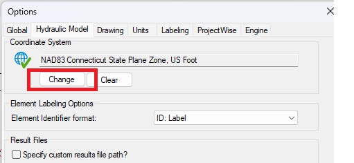

Changing the Model Coordinate System

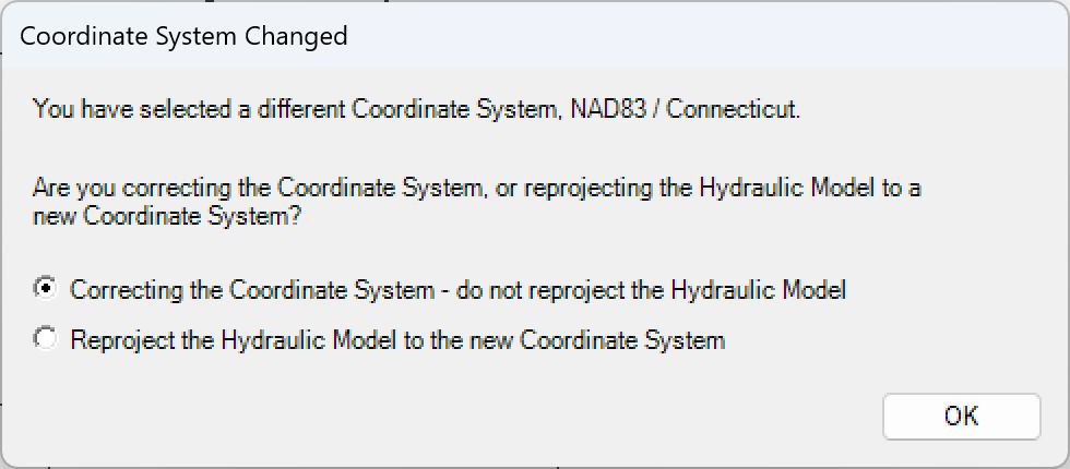

If you need to change the Coordinate System after you initially set it, you can do so from Options > Hydraulic Model. Click the Change button and select the new Coordinate System.
In version 26.00.00.XXX and higher, a prompt will ask if you want to reproject the data. This option should be used if the model's original coordinate system was correctly selected, but you want to change it to a new coordinate system and transform the model coordinates. If you simply need to correct the model's coordinate system because the wrong one was initially selected, choose the other option from the prompt, to simply change the designated coordinate system, without transforming/converting the model coordinates.

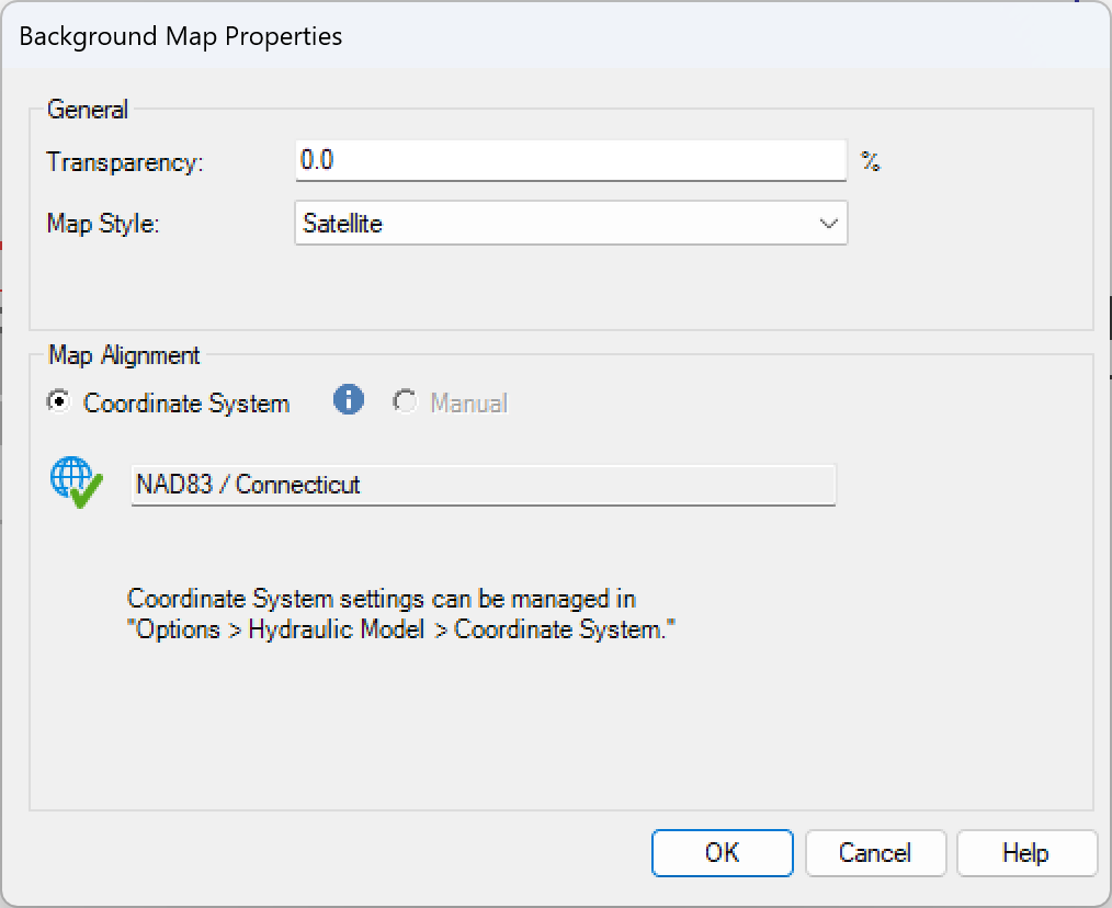

Using Coordinate Systems in Background Maps (Standalone)
Note: version 2024 and earlier used Bing Maps for the background map service, and version 2026 and later use Google Maps (and is referred to as simply "Background Map")
When adding a background map (road or aerial) from the Background Layers manager, if the model coordinate system is not yet set, you can click "Set coordinate system" to set it (see above).
If the model coordinate system is already established, the background map will automatically align with the model.

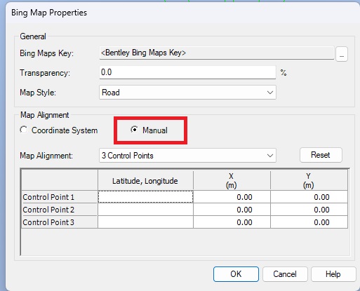

If you select the Manual option for the Map Alignment, you can still enter the 1 or 3 Control Point options to add a Background Map.
If you have set the Coordinate System for your Background Map and wish to revert back to the 3-point manual alignment method, you must clear the hydraulic model’s set Coordinate System. From File > Options > Hydraulic Model. Click the Clear button. Click OK, go back to the Background Map properties and select “Manual” under Map Alignment.

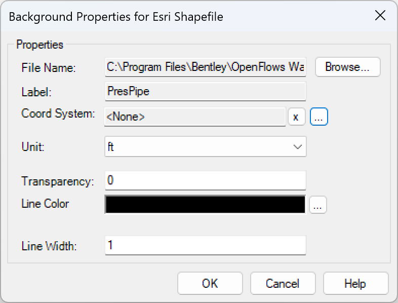

Shapefiles and DXF background layers support Coordinate Systems in version 2026 and higher and will automatically reproject to align with the hydraulic model's coordinate system, if different (and if the model coordinate system is specified).
For a shapefile background - its .PRJ file must be present in order for the OpenFlows application to detect its coordinate system. If the .prj is not present, you can optionally specify the coordinate system of the shapefile using the "..." button (see below) and it will reproject automatically to align with the model's coordinate system (if different). Otherwise if a coordinate system is not specified for the shapefile background, it is assumed to be the same as the hydraulic model.
Note: if a change is made to the model Coordinate System, you may need to refresh any Shapefile backgrounds if they are not aligning as expected. In the Background Layers manager, select the shapefile background, click Edit, then click OK. Repeat for any other impacted shapefile backgrounds.

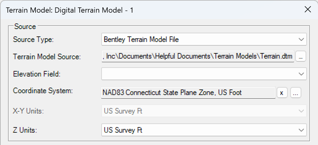

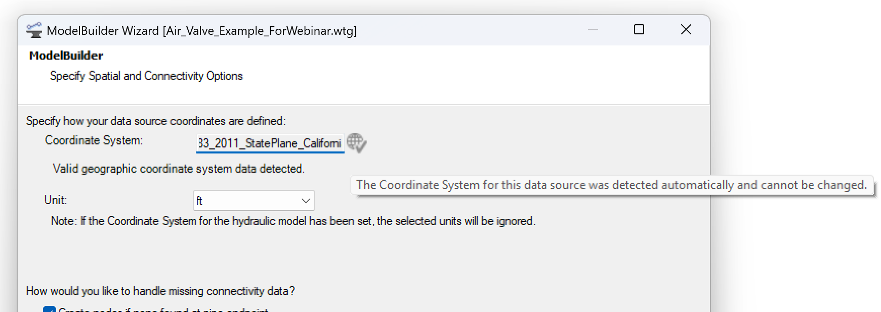

Using Coordinate Systems with ModelBuilder, Trex and Terrain Models
ModelBuilder, LoadBuilder, Trex and Terrain Models support Coordinate Systems in version 2026 and higher and will automatically reproject to align with the hydraulic model's coordinate system, if different.
When importing shapefiles with ModelBuilder, Terrain Extractor or the Terrain Models manager (Storm and Sewer products only), if the external file's coordinate system data is present (for example the .PRJ file for a shapefile), it will recognize the coordinate system and automatically reproject the data to the model's coordinate system if they are different. This ensures the imported data aligns with the model data and is imported to the right location.
If the shapefile .PRJ file is not present, or if you are importing another file type that does not have coordinate system data, you can optionally specify (assign) the coordinate system using the "..." button and the imported data's X and Y coordinate information will reproject automatically to align with the model's coordinate system (if different). Otherwise if a coordinate system is not specified, it is assumed to be the same as the hydraulic model.

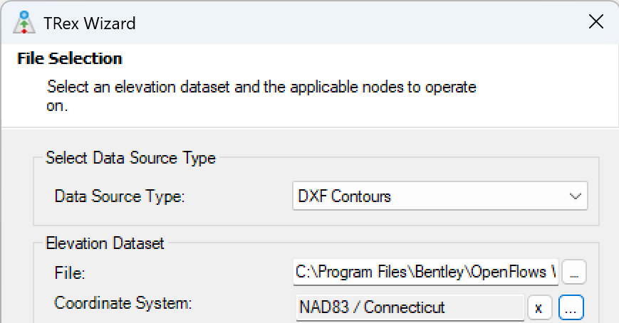

Terrain Extractor (Trex):
(manually selected)
Terrain Models (storm and sewer products only):
(manually selected)
