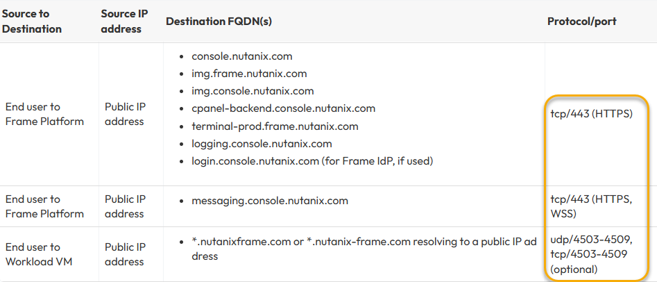

2) Negotiation Timeout error code 5007,
Issue establishing a connection between local computer and the Nutanix environment due to network connectivity problems or firewall restrictions.
Suggested Actions
