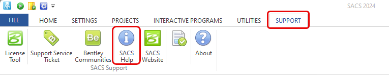

To get more details on the Grid services, in Executive > Support > SACS Help

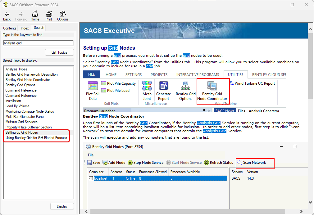

Search for Analysis Grid:
- Setting up grid nodes
- using Bentley grid for GH Bladed
SACS license needs to be available on all computers that run SACS. Refer to Setting up Grid Nodes in the SACS Help as shown above to get details on how to set up computers for the grid.
