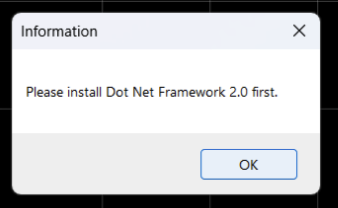

Error when opening project page "Please install Dot Net Framework 2.0 first" in OU Substation
Introduction
 Product(s): OpenUtilities Substation CONNECT
 Version(s):  10.XX.XX.XX to 24.XX.XX.XX
 Environment:  NA
 Area:  Installation_Configuration
 Subarea:  NA
Background:
When installing OpenUtilities Substation (OUS) on a new machine, the user might get the error message below after the software has been installed and they try opening a project page. This message indicates that the .Net 2.0 (It is part of .Net 3.5) is not installed or turned on on the new machine.
Instructions
Note: This step involves the installation / Enabling of Windows Features and you may need help or guidance from your IT Team.
Please follow the steps in the below link from Microsoft to Install or Enable .Net 3.5.
Install .NET Framework 3.5 on Windows 11, Windows 10, Windows 8.1, and Windows 8
