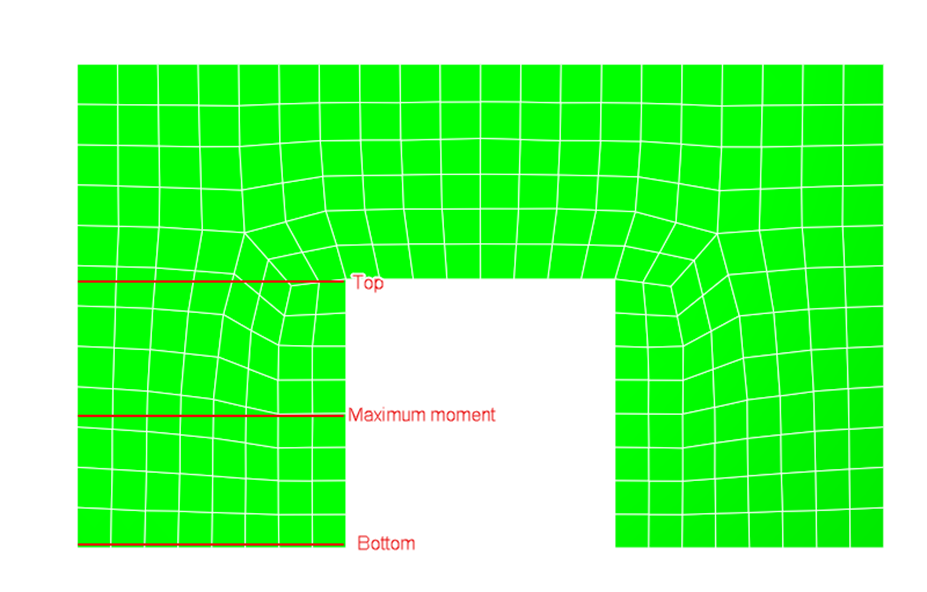

For each segment to design bearing walls or shear walls we get three sections, the top, bottom and maximum moment (in-plane for shear and out-of-plane for bearing) section.
 Wall section cuts for design
Lintel section cuts for design

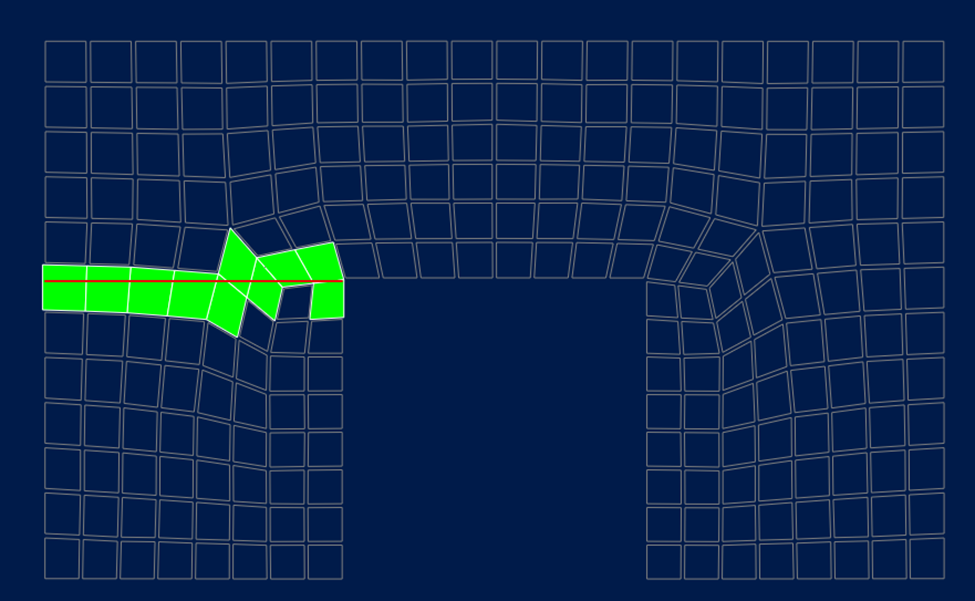

2.    Identify Shell Elements Crossing the Section Cut
Determine which shell elements intersect the defined section cut plane. These elements contribute forces to the section cut.
If necessary, find the precise intersection points on the shell element edges. This step can be simplified if the cut is aligned with the shell mesh.
 Shell elements that intersect with Section Cut

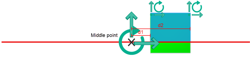

4.    Resolve Corner Forces to the Section Cut
For each shell element crossing the cut, resolve the nodal forces to the section cut plane.
Decompose forces at each node into components parallel and perpendicular to the cut plane. This step may involve transforming the force vectors from the global coordinate system to the local coordinate system of the section cut.
This transformation helps isolate shear, axial, and bending contributions along the section cut direction.
Corner Forces that are above Section Cut

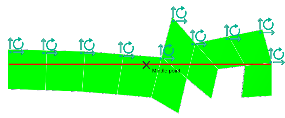

5.    Calculate Resultant Forces and Moments
Sum the force components (shear, axial, and normal) and moments from each shell element along the section cut to find the resultant forces and moments.
Moment contributions can be calculated by multiplying the resolved forces by their perpendicular distance to a chosen reference point on the section cut (often the centroid of the cut line or a chosen origin).
Ensure that the equilibrium equations hold, confirming that your resultant forces accurately represent the internal load transfer along the section cut.
To have an accurate resultant, the internal pressure forces applied to the element should be considered in the equilibrium. So, the pressure on the upper shell polygon should be calculated and the gravity center. Consider that the pressure could be uniform and variable.
Resultant force at middle point

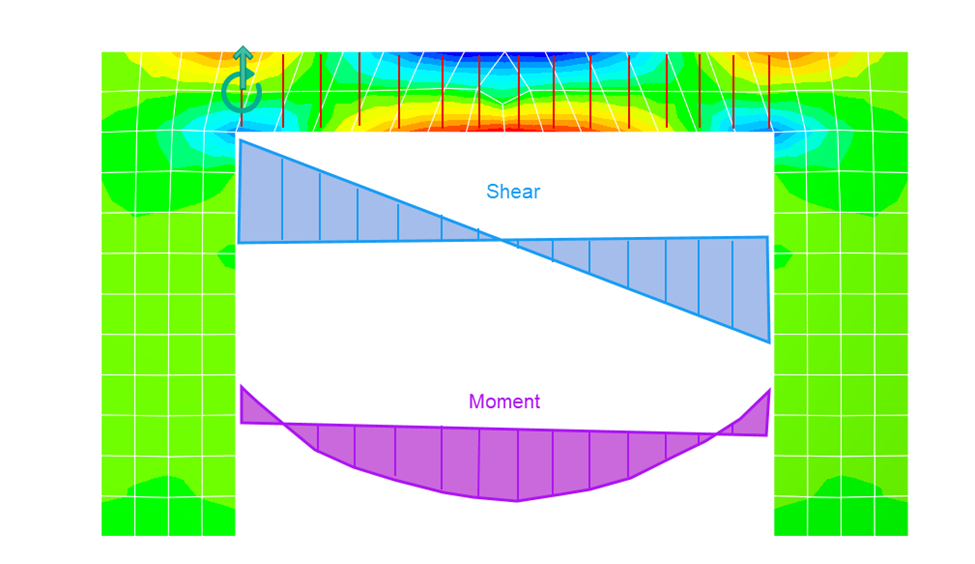

7.    Interpret and Apply Resultant Section Cut Forces
Use the resultant forces and moments to understand the load-carrying behavior across the section cut. These results can reveal information about internal stresses, structural performance, and safety margins.
For design or analysis, the resultant section forces may be compared to material strengths, safety requirements, or serviceability limits as part of a larger structural evaluation.
