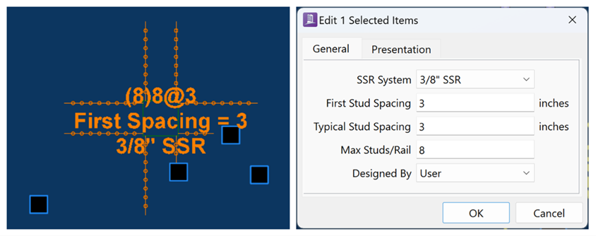

  2. Open a plan on the Reinforcement Layer that displays the Program SSR, select one or more SSR groups, and view its properties (Edit menu > Selection Properties or click Selection Properties using the right-click menu).
  3. In the object properties dialog, change the Designed By selection to User. After this change, the following object properties may be modified:
    • SSR System – the assigned SSR System from the Material table
    • First Stud Spacing – the spacing to the first stud on each rail
    • Typical Stud Spacing – the spacing of studs after the first stud on each rail
    • Max Studs/Rail – the maximum number of studs on each rail
  4. Click OK to close the dialog after making any desired property changes.
  5. Note that the User SSR group is displayed in orange (similar to user-defined longitudinal reinforcement) to differentiate it from Program SSR groups, which are displayed in gray.
  6. Run calculations to check the punching shear design with the User SSR
Figure 1 - User SSR Group and Property Dialog

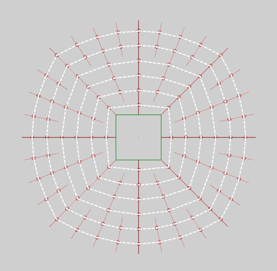

Design codes do not provide clear guidance for calculating the transverse rail spacing for all possible SSR configurations, especially those with irregular geometry. RAM Concept adopts a rational and proprietary calculation method that can be applied to all punching shear section geometries and SSR designs.
In RAM Concept, transverse spacings are calculated using the line segments that form the stud perimeters of the SSR design. The transverse rail spacings are determined from the lengths of these line segments. See Figure 2 for an illustration of the peripheral lines of stud for a sample SSR design. In the figure, each of the white-dashed line segments that connect two adjacent studs are stud perimeter segments.
Figure 2 - Peripheral Lines of Studs for a SSR Design

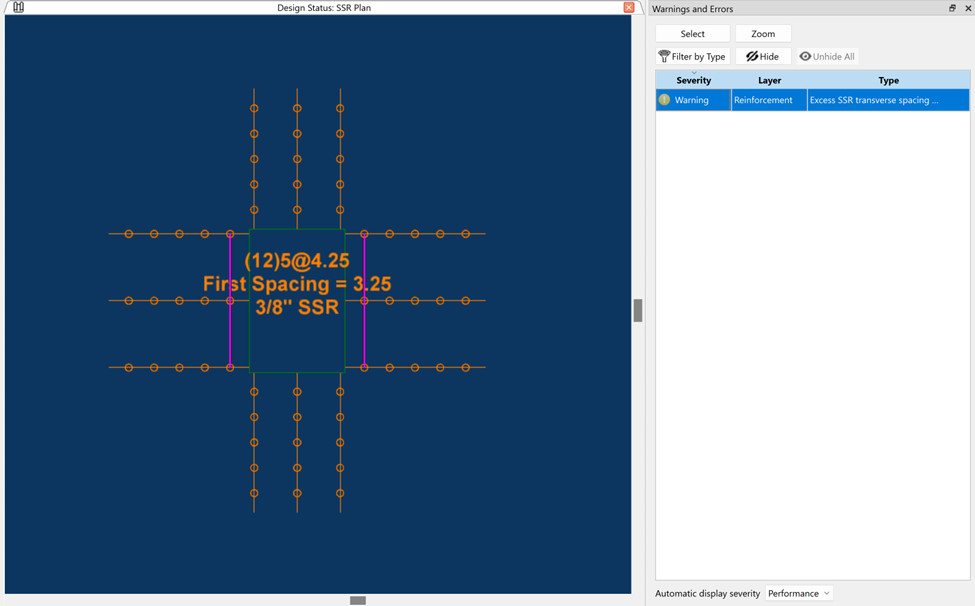

A punching check at (x,y) has one or more shear stud rails that may exceed code transverse spacing limits
This warning occurs when the calculated transverse rail spacing in a SSR design exceeds the design code limit. The transverse spacing failures are reported in the Punching Check Auditor and can be displayed on screen using the Display Warnings Tool (see Figure 3). In some cases, the warning may be ignored based on engineering judgment. For punching checks with User SSR, the warning can often be eliminated by deleting the User SSR and re-running the calculations so that a new Program SSR group is detailed by the program.

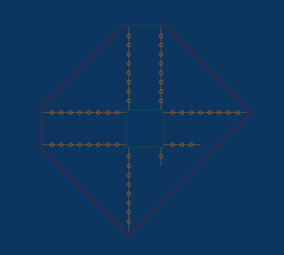

One or more rails in User SSR at (x,y) are not fully extended to the critical section and may not be fully effective
This error occurs when User SSR includes one or more rails that were previously trimmed due to floor geometry but can now be fully extended to match the other rails due to geometry changes. For example, this error would be produced for the User SSR design shown in Figure 1 if the slab openings were deleted and the calculations were re-un. Figure 4 below shows the resulting User geometry and the cut-off punching shear section that RAM Concept would use if the error is ignored.
This error can be resolved by deleting the User SSR and re-running the calculations so that a new Program SSR is detailed by the program. The Program SSR can then be changed back to User SSR and its properties can be modified as required.
