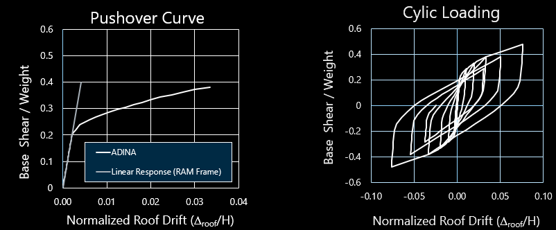

In addition to the traditional plastic, thermo-plastic, cyclic and viscoelastic materials, Link Elements can now also be used with two new materials in ADINA: Takeda and Degrading-Plasticity.  These two new materials include superior capabilities to represent the behaviour of reinforced concrete structures, including nonlinear cyclic hysteresis response, bounded by a user-defined backbone curve, peak-oriented, pinching or bilinear type of uniaxial response.

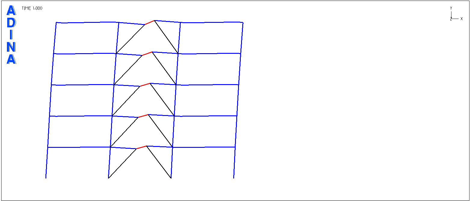

Link elements can be used in models:
A screenshot of a graphDescription automatically generatedA drawing of a gridDescription automatically generated with medium confidence

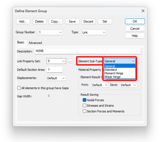

Link Element Sub-Types
Depending on the structural behaviour to be modeled, a link element sub-type must be selected.
There are four link element subtypes available in ADINA:
Link Element Type
Degrees of Freedom
General
Finite-length
6 (3 Translations, 3 Rotations)
Standard
Finite-length
3 (3 Translations) (1)
Moment Hinge
Zero-length
3 (3 Rotations, Translations are constrained) (2)
Shear Hinge
Zero-length
3 (3 Translations, Rotations are constrained) (3)
(1) The Standard link element behaves as “pinned” at its ends (similar to a truss element).
(2) By default, Moment Hinges have their translational DOFs rigidly constrained; this setting can be changed.
(3) By default, Shear Hinges have their rotational DOFs rigidly constrained; this setting can be changed.
General Note: At the moment, all DOF on each link element subtype are independent from each other (i.e., no coupling between axial and rotation).
Some examples of possible applications are shown below. The list is not exhaustive.
Application Examples (not exhaustive)
General
Structural members or links with restrained ends and plastic or cyclic behaviour.
Standard
Structural members or links with pinned ends and plastic or cyclic behaviour.
Moment Hinge
Concentrated moment-rotation plastic hinges at sections of expected plasticity (high moment)
Shear Hinge
Concentrated force-deformation plastic hinges at sections of expected plasticity (high shear)
The link element sub-type can be selected from the Link element group definition dialog.
Figure 1: Link Element Group definition dialog (Element Subtype selection)

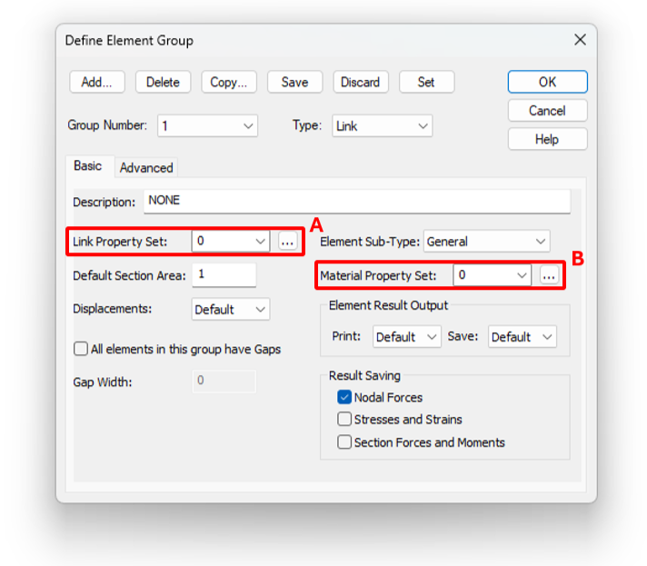

Link element material properties can be specified using either:
  1. Link Property Sets
  2. Material Property Sets
Figure 2: Link Element Group definition dialog (Link Property vs Material Property)

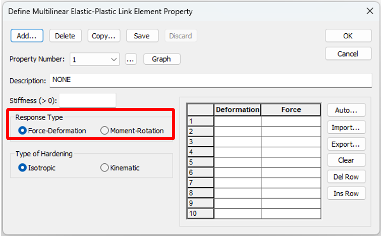

These are purposely created material properties for Link Elements.
They are defined by Force-Deformation or Moment-Rotation sets of values.

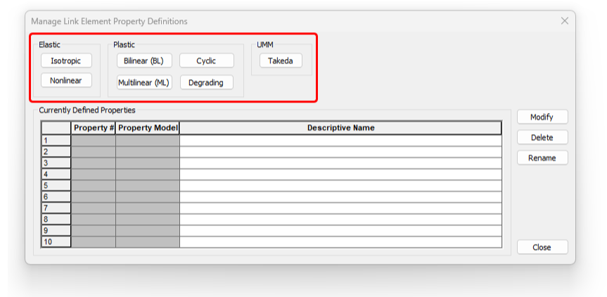

The following Link element material models are currently available in ADINA:
Figure 3: Link Element Property (available models)
Figure 4: Link Element Property example (defined as Force-Deformation or Moment-Rotation law)

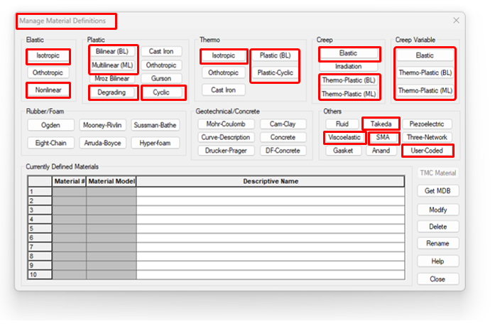

  1. Material Property Sets
Amongst the general material models in ADINA, some can be applied to Link elements.
When the Link Element material is selected using this method, Stress-Strain inputs are required.
Figure 4: Available material models for Link Elements (highlighted)

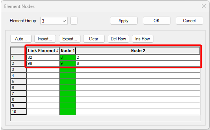

To define the element topology, we navigate to Meshing > Elements > Element Nodes and we populate the table for each existing Link Element Group. The Link Element number can be freely chosen. Node 1 and Node 2 fields represent the two nodes to connect via a Link Element.
For each zero-length Link Elements (i.e. Shear and Moment-Hinges), Node 1 and Node 2 will be coincident (will have the same coordinates).
Figure 5: Link Element topology definition (Element Nodes)

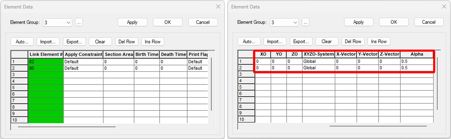

To define the element orientation (and other optional settings), we navigate to Meshing > Elements > Element Data and we populate the table for each existing Link Element Group. Here we explain some of these entries:
Figure 6: Link Element orientation (Element Data)
