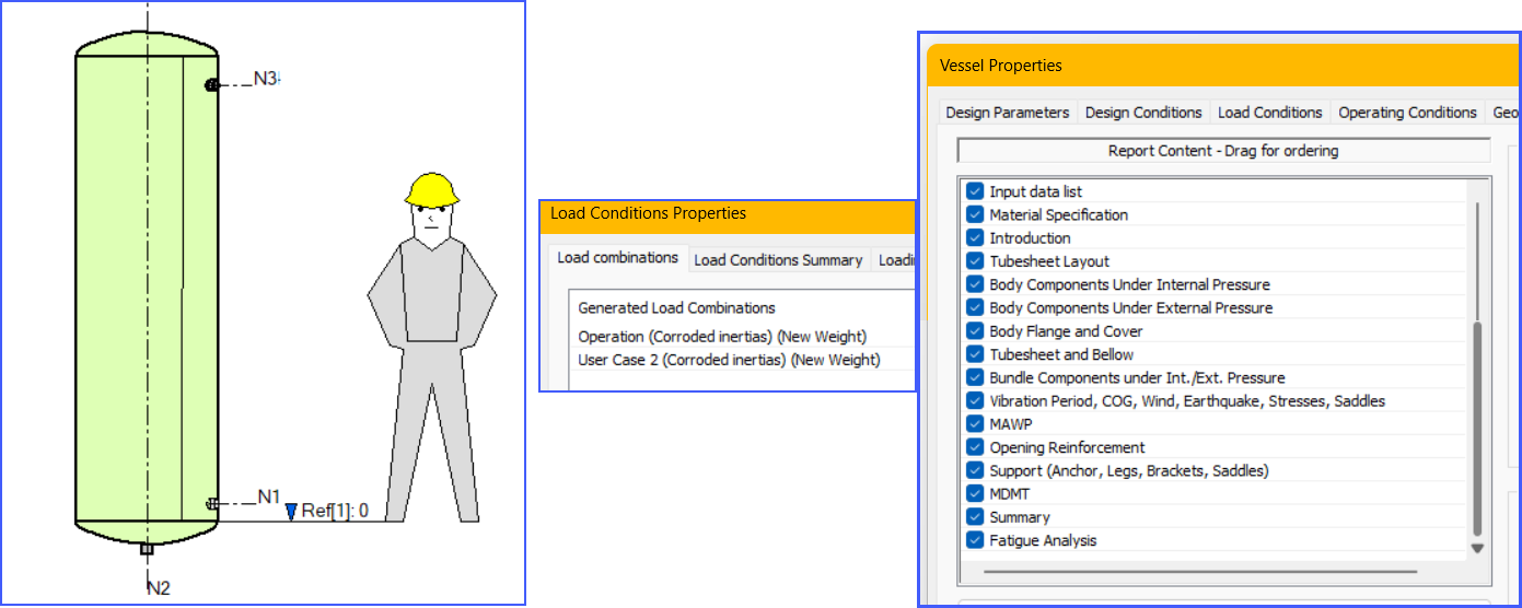

When creating a model of a vessel that incorporates user-defined load cases, it is important to note that these load cases, also referred to as Combination loading, will not be included in the output report until the vessel model is finalized. This means that all minimum input be added to the program before the inclusion of these load cases in the output.
Example:
The following vessel was modeled, load cases added as indicated below, and all sub reports enabled:

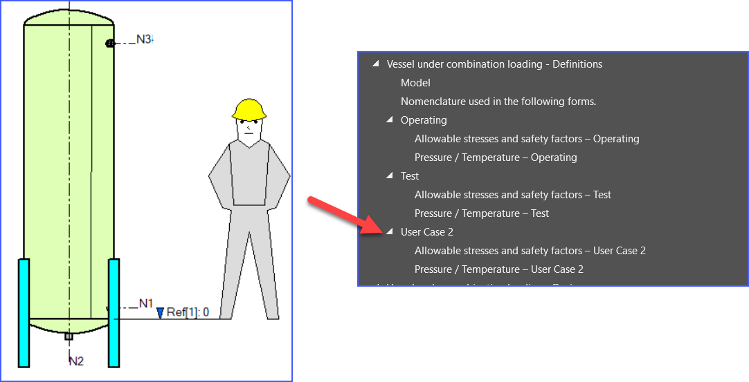

With supports added to the model, the output report contains information pertaining to User Load case 2:
