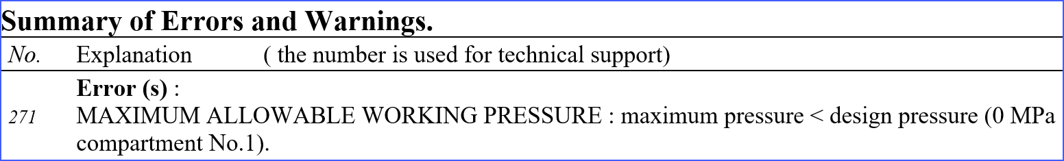

271       MAXIMUM ALLOWABLE WORKING PRESSURE : maximum pressure < design pressure (xx MPa compartment No.xx).
As mentioned by the error text, the reported MAXIMUM ALLOWABLE WORKING PRESSURE is less than the design pressure. Open the complete report to "MAXIMUM ALLOWABLE WORKING PRESSURE" sub report, and review to find the issue.

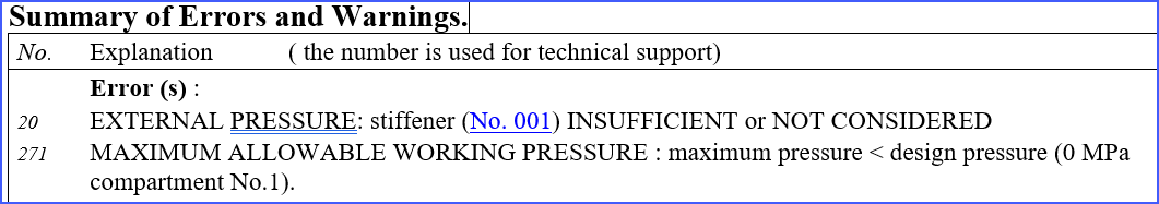

Given the error:
After reviewing the complete MAXIMUM ALLOWABLE WORKING PRESSURE report, found:
item 02 / 31.05 is not sufficient to support the external pressure, the maximum external pressure is therefore set to zero.
Modify item 02 / 31.05 as needed until the message is no longer shown (consider increasing the item size, etc..).
Note: Recommend to review all Errors and Warnings to see if any others may help to find a cause for this Error message 271. In a particular model with the above mentioned Error, the following additional Error was also found:
Therefore Error 271 is a consequence of Error 20 on the stiffener. Fixing Error 20 would resolve Error 271.
Suggest to increase the stiffener size.

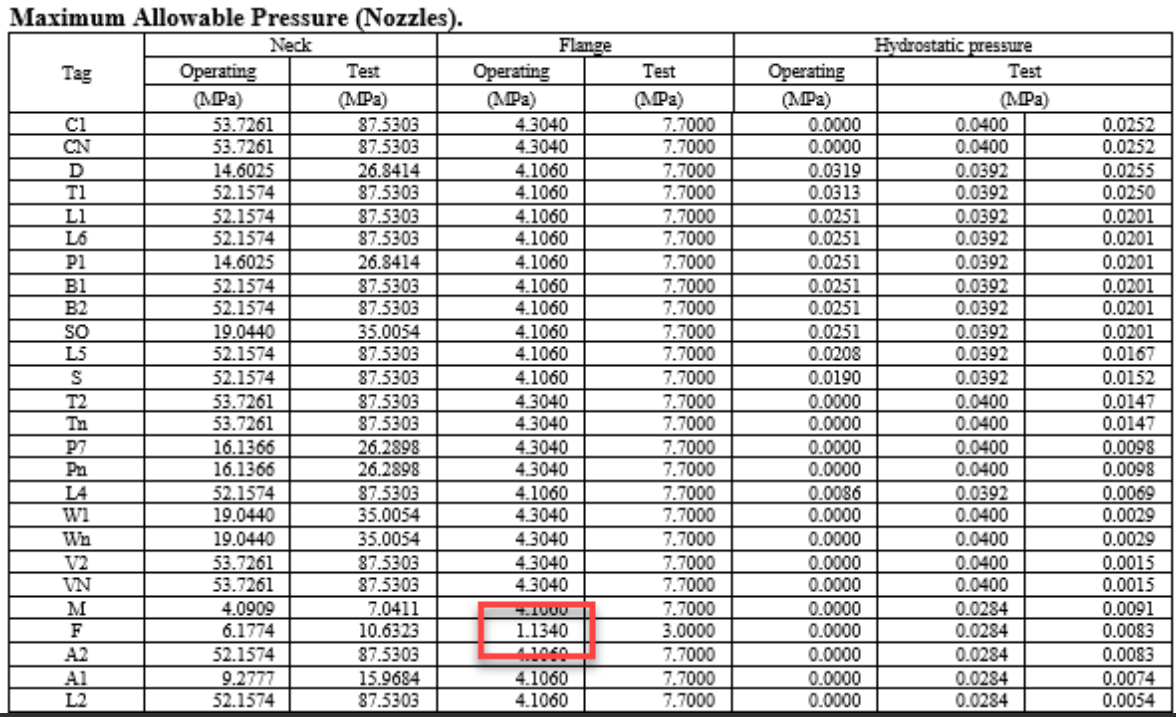

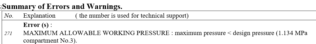

User's design was constructed with the third chamber having the capability to withstand operating and design condition higher pressures than 1.134 Mpa. Therefore, why is the error appearing
After reviewing the complete MAXIMUM ALLOWABLE WORKING PRESSURE report, find:

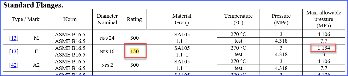

From the Summary of forged items find:

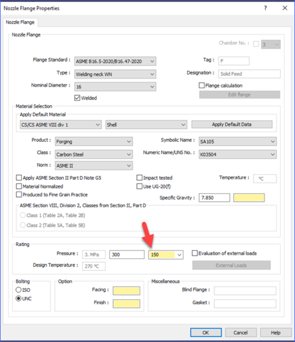

A flange rating of 150# is the reason why the MAWP of chamber #3 is limited to 1.134 MPA.
In order to increase the MAWP of chamber 3, suggest to increase the flange rating from 150# to 300#.
