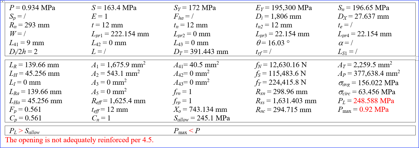

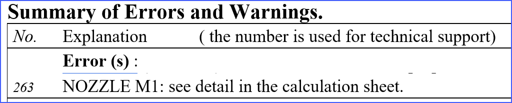

The following message appears in AutoPIPE Vessel, how to avoid it?
263          NOZZLE xx: see detail in the calculation sheet.
As mentioned by the error text, see details in the calculation sheet. Open the complete report to the Isolated Opening(s) sub section, and find the referenced opening (example Nozzle M1) and scroll down the report to see red lettering.
Example:
As shown above both the values "PL" and "P" exceed their respective maximum values. Modify the model as needed until the message no longer appears (ex. consider increasing the nozzle thickness, etc...).
