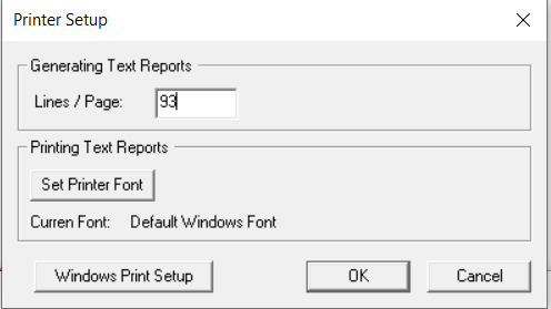

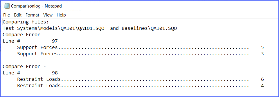

Issue #1:
Comparison report shows difference in Table of contents:
Also, each model compared, or total length of report is excessively long.
Example: Standard license selected; comparison report contains 63000+ lines.
As mentioned in the ATS readme file, under Instructions;
- "The printer configuration for the "number of lines per page" must be set to ninety-three (93)."
Rerun the ATS.
