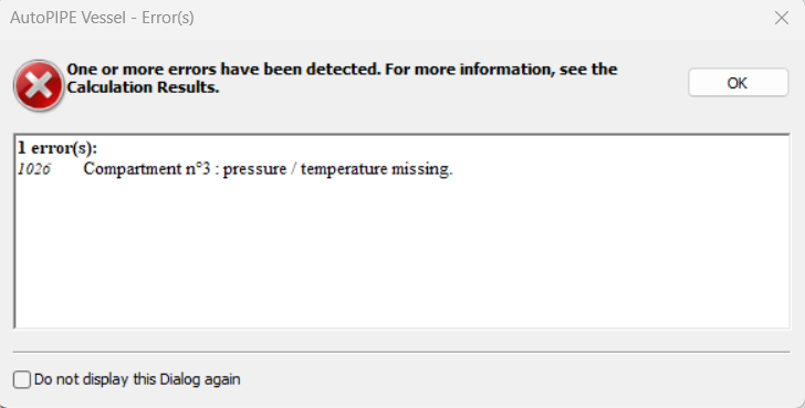

Error Code 1026 - Compartment n°3 : pressure / temperature missing.
Product(s): AutoPIPE Vessel
Version(s): ALL
Area: Error Message
Date Logged
& Current Version
January 2025
45.00.03.001
The following message appears when using AutoPIPE Vessel,
1026: Compartment n°3 : pressure / temperature missing.
why and how to avoid?

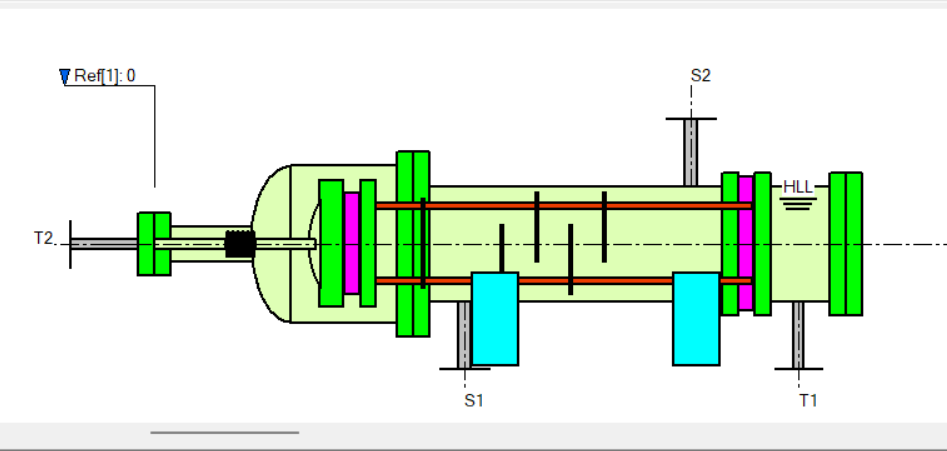

User Heat exchanger construction type is "AES", Refer below image for reference.
For this specific type of heat exchanger, it is necessary to input the diameter of the head (17.12) and the cylindrical shell (17.08).
Update the details, and you will not encounter the above error.

      1. Shell and Tube Inlet/Outlet Nozzle not correctly defined as Inlet / Outlet for their respective chamber. Model was found with all 4 nozzles assigned to Shell Inlet Nozzle. Solution, redefine 3 nozzles correctly for Shell Outlet Nozzle, Tube Inlet Nozzle, and Tube Outlet Nozzle.

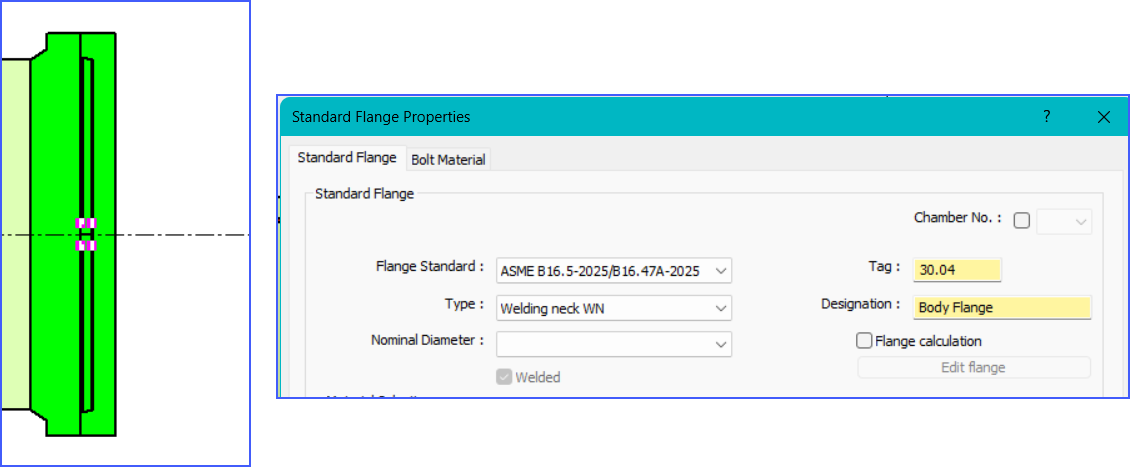

      2. Imaged below is a defined Welding neck WN incorrectly added to the model. Component should be deleted from the model.
