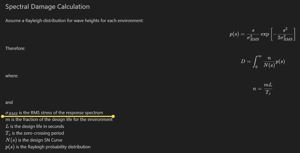

3. Which Sigma RMS is used by SACS to calculate the damage?
The damage formula in the Fatigue manual is used for DA (double amplitude).
