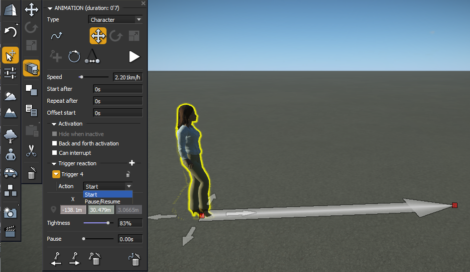

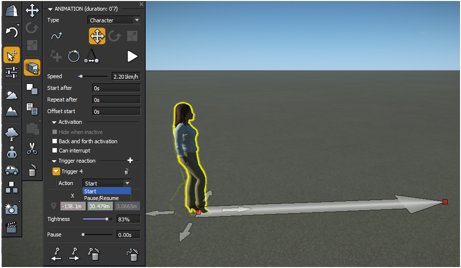

Animation react: (start, pause/resume)

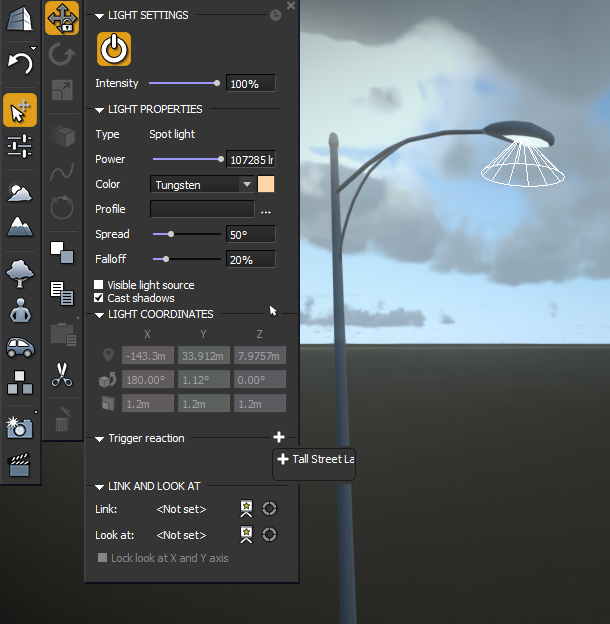

Light react: (Switch On/Off)

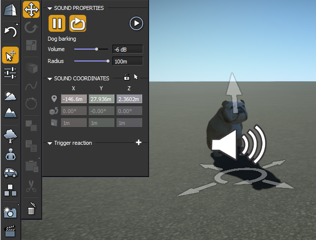

Sound react: (Switch Play/Pause)
  • Hide when inactive - Hide the animation when paused.
  • Back and forth activation - Start the animation back and forth (normal, reverse, normal, reverse, etc.).
  • Can interrupt - Start event can interrupt a running animation otherwise it will just do nothing.
