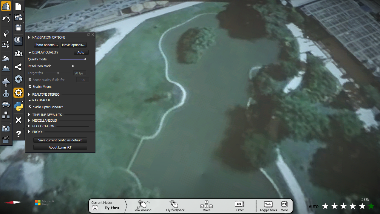

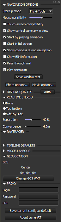

User Settings
This option is used to set your user preferences for navigation, display quality and Time-line defaults while working on your scenes.
Setting Description
Navigation Options
  • Startup mode - Selects which of the basic mouse navigation modes to use as a default.
  • Mouse sensitivity - Adjust this slider for faster or slower mouse camera movement driven by the mouse.
  • Touch-screen Compatibility - Help user which have touch screen.
  • Show control summary in view - Displays the illustrated navigation help window at the bottom of the screen.
  • Start by playing animation - Begins the LiveCube session with an animation if one is present.
  • Start in full screen - Expands the LiveCube window to the entire screen at startup time. Clicking alt+enter will also expand the LiveCube to the full screen.
  • Show compass during navigation - Checking this option displays a compass in the lower left corner of the screen.
  • Show BIM information - Check to show Building Information Modeling information.
  • Photo options - Displays the Photo Options dialog for defining size and quality.
  • Movie options - Displays the Movie Options dialog for defining resolution and quality.
Display Quality
If you click "Auto", the Quality and Resolution mode sliders display for adjustment.
  • Quality mode - Adjusts the visible graphics quality. If set to less than 100%, it will reduce or eliminate various graphics effects such as real-time reflections, shadows, and animated plant and character movements.
  • Resolution mode - If set to less than 100% will reduce the visible resolution to aid in performance.
  • Target fps - Indicate the frames per second rate.
  • Boost quality if idle for - Check and set the time if using this option.
  • Enable Vsync - You have the option to use Vsync if you choose.
Realtime Stereo
  • Renders a view with a stereo effect (form the drop-down options). It is used for viewing with special red/blue filtered glasses in your scene. Stereo can be set side by side or top bottom.
  • Separation - Sets the measured offset between the two rendered images. The Default is 65 millimeters, it can be adjustable as per the scene.
  • To omit the Stereo command press 'Tab' key.
RAYTRACE System having RTX card or if Raytracing is available, it shows "DX12/Raytracing"
Timeline Defaults
  • Pace - Use the slider to set the pace or speed of movement through the scene.
  • Default pause time - Key in a value for the default pause information.
  • Images are visible for - Key in a value for the time an image is visible until it moves to the next image.
  • Set default transition - When clicked, this displays a dialog to define the duration and type of transition. There are several types of transitions available. You can set the duration of the transition, then select a type of transition from wipe to slide, push or empty.
Miscellaneous
  • Units - Sets scene units to use metric or imperial units.
  • Left-hand side traffic - When clicked, the traffic tool will create cars using left-hand rules.
  • Quick Reload from Plant Factory - Automatically reload the vegetation from plant factory
GEOLOCATION Define the GCS (Geographic Coordinate System).
PROXY
Set Current config as default Sets current configuration as default user setting
About LumenRT This displays a splash screen with product name and the number of the current product build.
