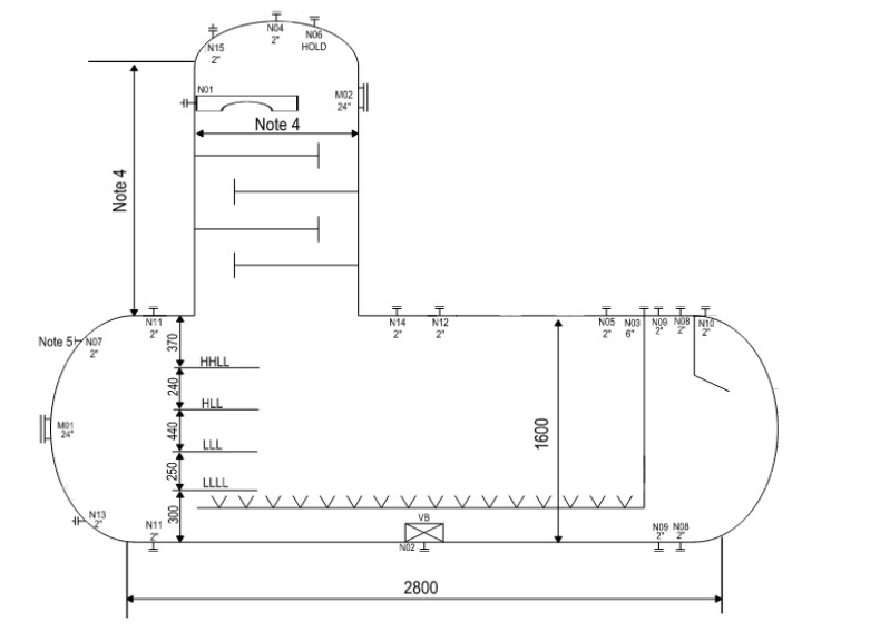

How to model vessel on vessel (small vertical vessel mounted on nozzle of horizontal vessel)?
Configuration same as follows,

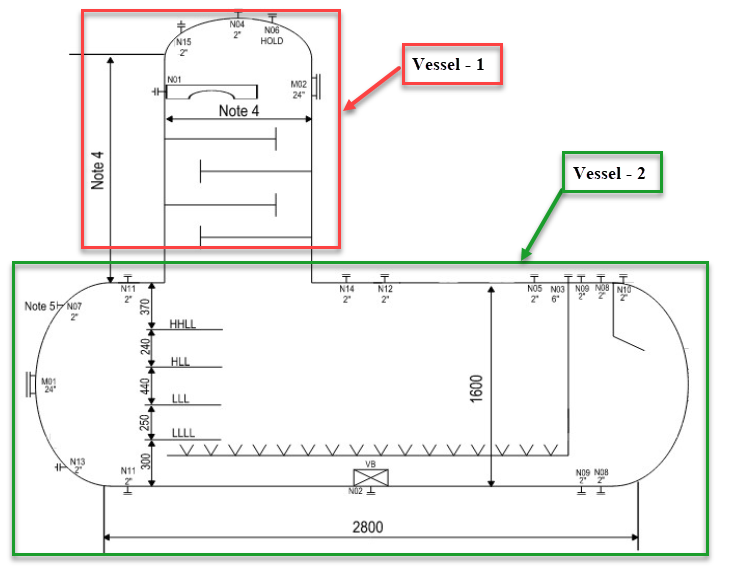

AutoPIPE Vessel does not have the feature to model this type of vessel directly.
However, User can use a workaround by modeling it as two separate vessels. Please refer to the snapshot below for your reference.
First, model Vessel-1 as a vertical vessel and note down its weight and loads.
Then, model Vessel-2 separately. User must include the opening in the green model and add the weight and loads of Vessel-1 to Vessel-2 as external loads to match the actual scenario.
