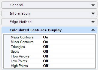

1. Open the properties dialog and select the terrain model.
2. Toggle On the major and/or minor contours.
