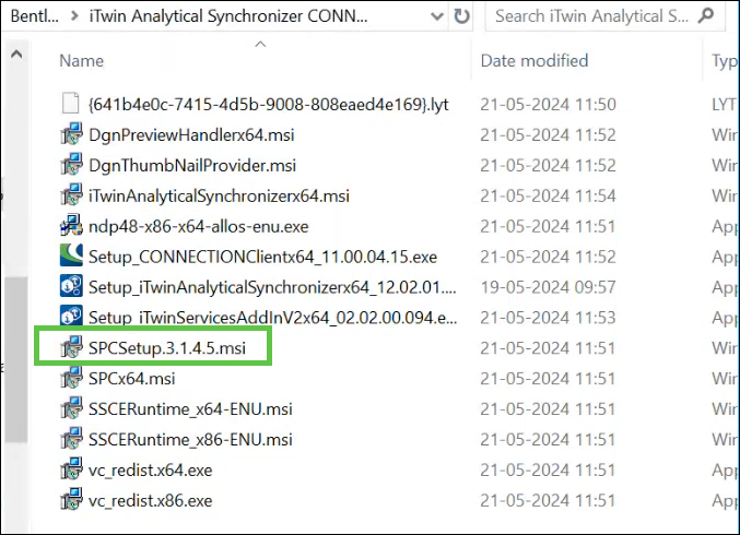

3. Create a deployment image of compatible iTwin Analytical Synchronizer application.
4. Go to the path of deployment image and install the file SPCSetup.3.1.4.5.msi.
5. Restart the machine.
