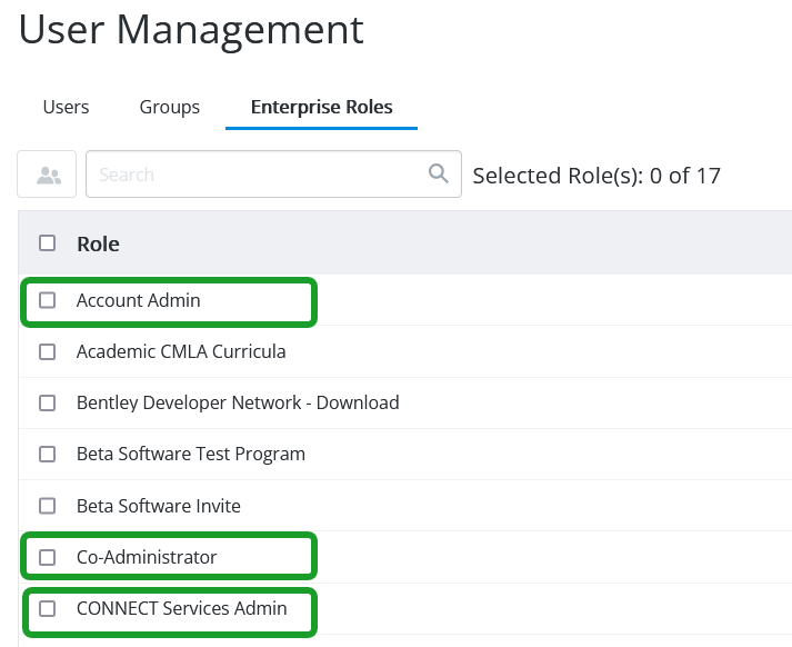

To be able to Register a Project in Bentley Infrastructure Cloud, a user needs to have one of the following IMS Enterprise Roles:

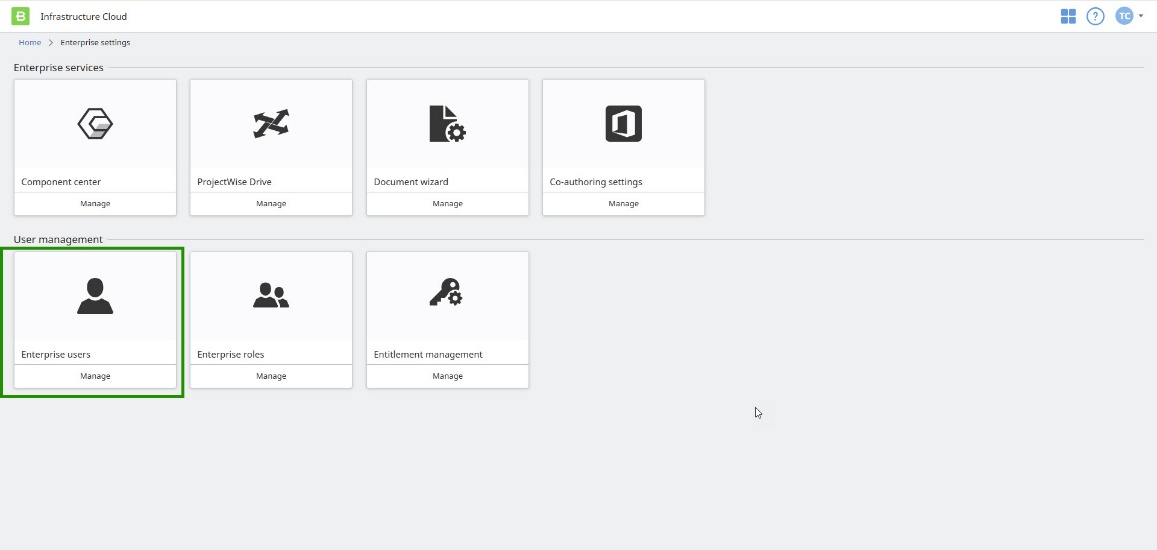

These roles can be found in Enterprise Services – Enterprise Users
And select Enterprise Roles
[Note: Available Enterprise Roles - Please refer to this Article.]

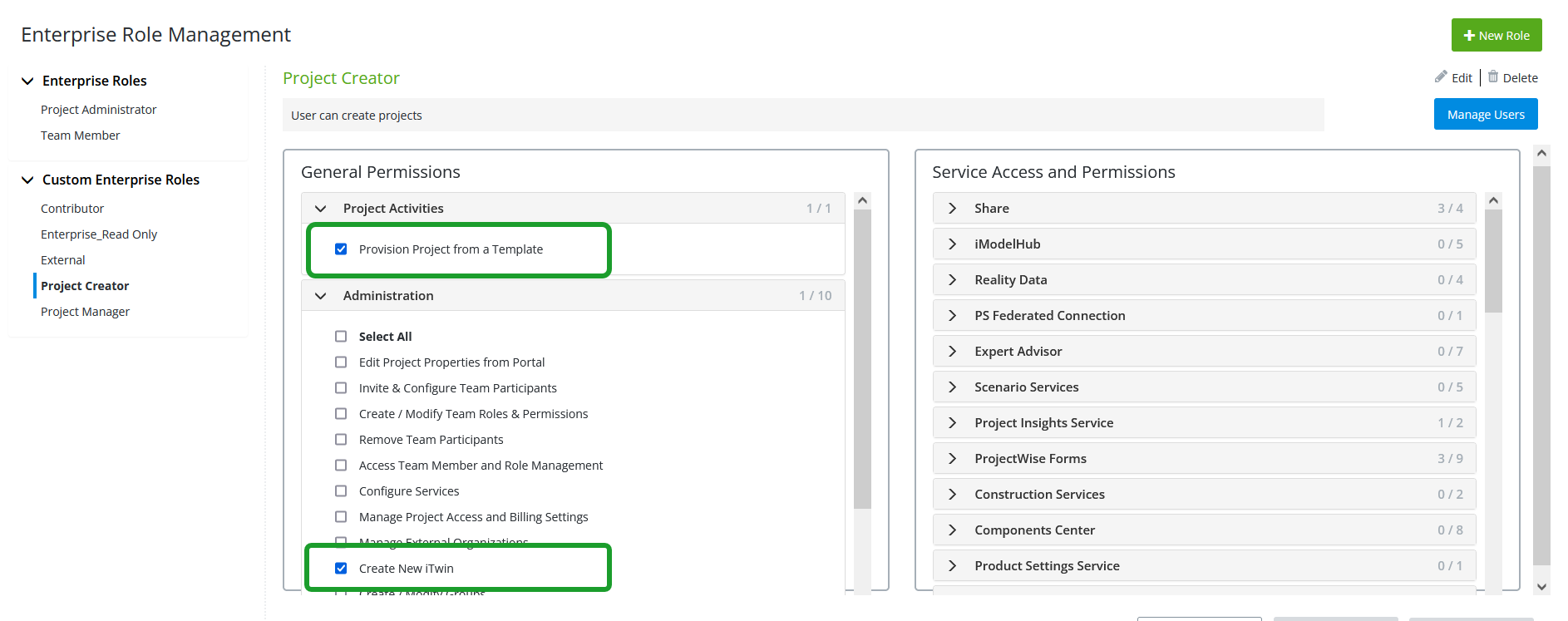

Belong to an RBAC Enterprise Role that has Provision a Project from template and Create new iTwin rights enabled.

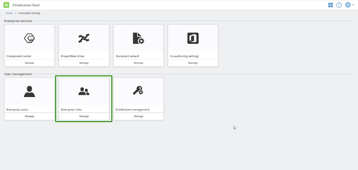

Select Enterprise Services – Enterprise Roles
Create or modify an existing RBAC Enterprise role
