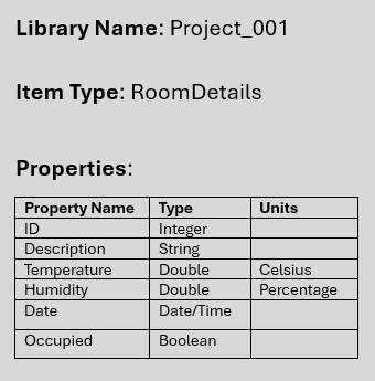

We will create an Item Type with the structure shown in the image below.

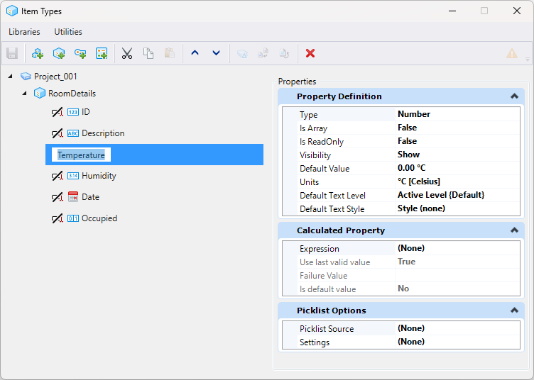

Run/Execute project
Load the project “Create_ItemType.py” from the Python Editor dialog and Run/Execute the python script.
Item Type is created as illustrated below.
Happy coding!
