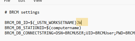

When the user selecting OK once all the variables are set in the XML Import, nothing happens.
Steps to Resolve
  1. Launch File Explorer
  2. Go to the  workset cfg file which is located in C:\ProgramData\Bentley\BRCM 2024\Configuration\WorkSpaces\%workspace_name%\Worksets\%workset_name%\Standards\BRCM.cfg
  3. In BRCM_DB_ID configuration variable, append the current value with a unique identifier
  4. Save BRCM.cfg
