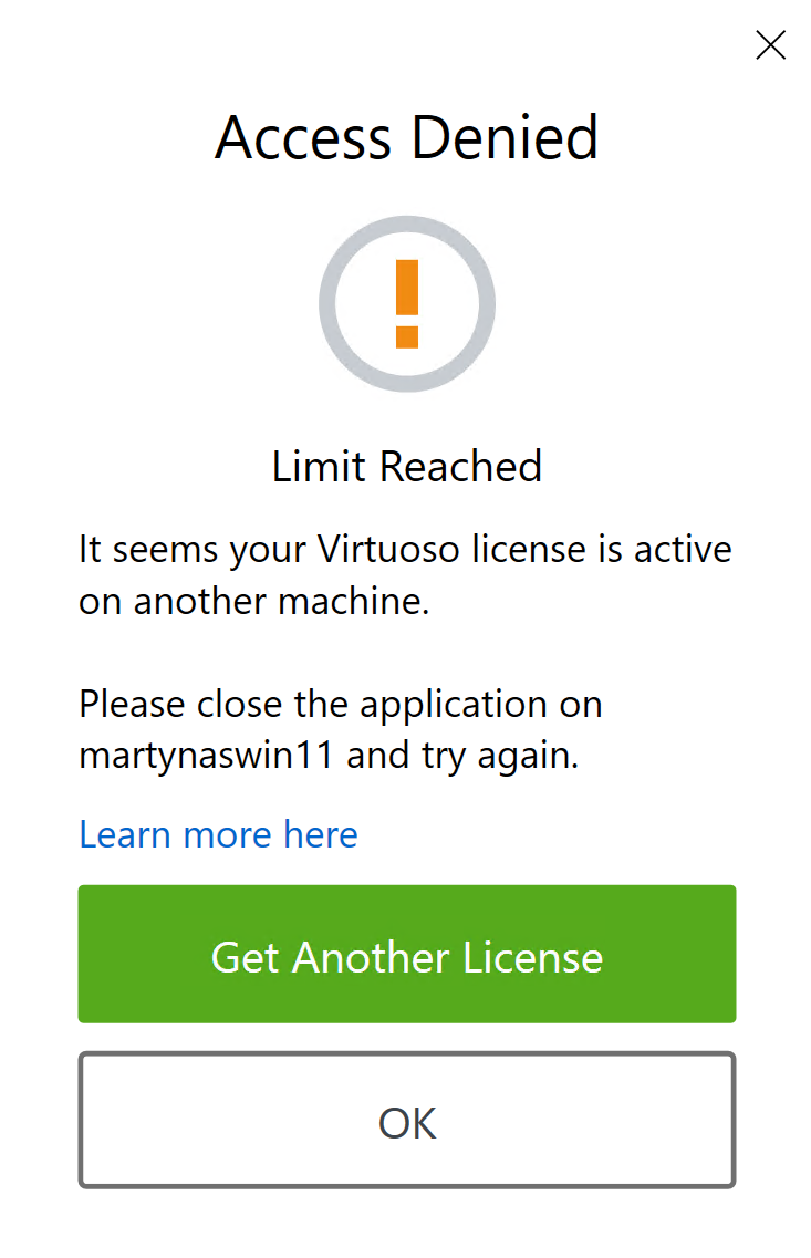

In CONNECTION Client 23.00.01.25 or greater, the message the user will receive looks like this:
Capped Virtuoso Message - New CC

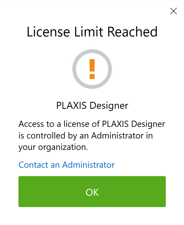

For CONNECTION Client versions older than 23.00.01.25, the user will receive a generic License Limit message:
