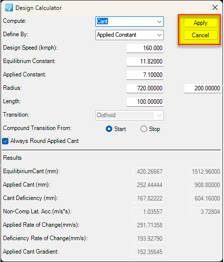

1. Design Calculator
Design Calculator allows to calculate cant, speed and radius values. These values are automatically written onto the attached speed table.
A screenshot of a computer
Description automatically generated

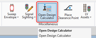

Behavior of the design calculator is different based on where it is started from. When started form the ribbon as a standalone dialog it displays Copy to Clipboard controls, for copying the calculated results for later use.

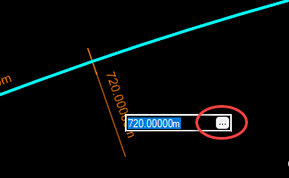

If calculator is started through a radius field, you instead get Apply/Cancel commands.
