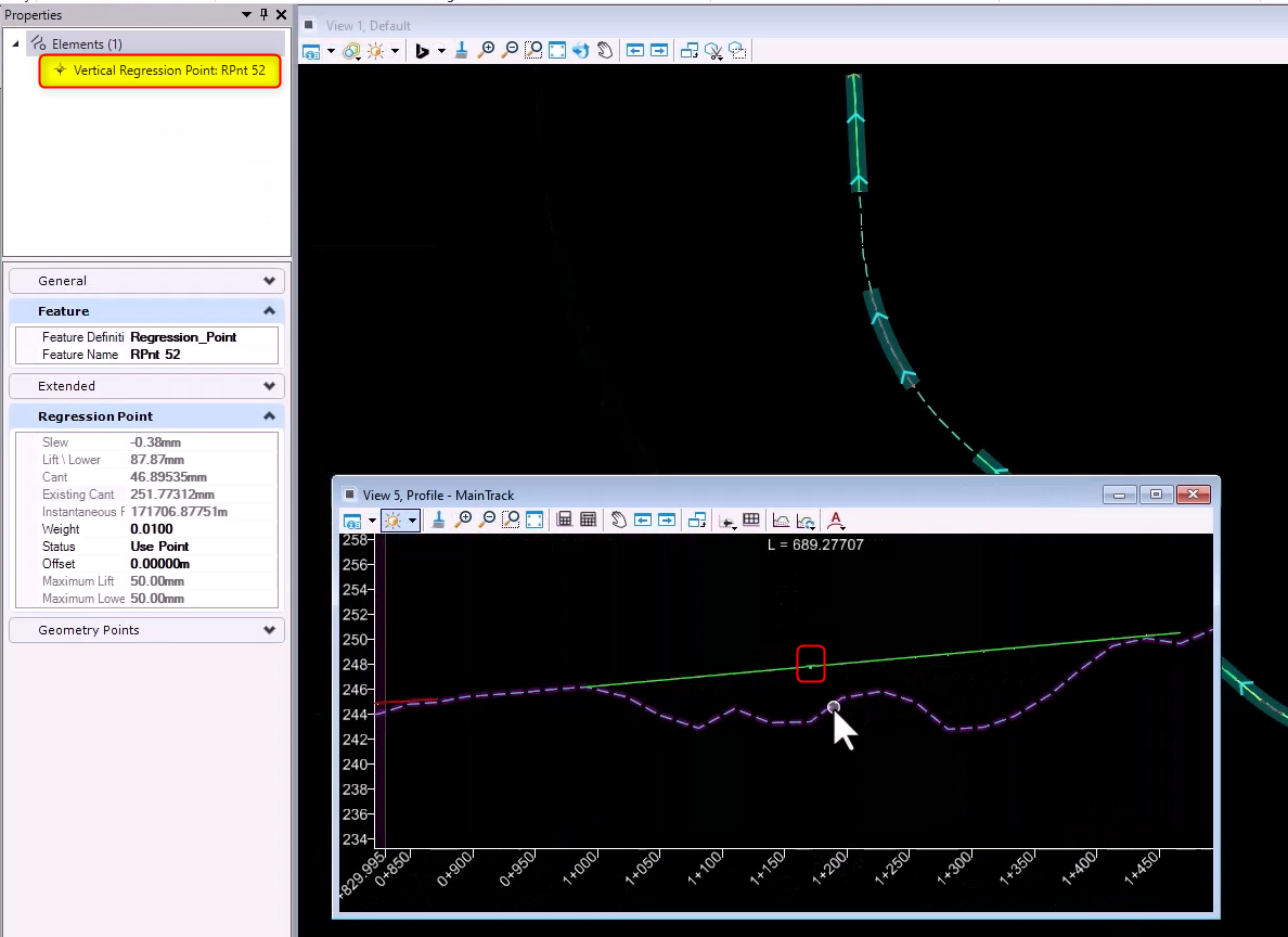

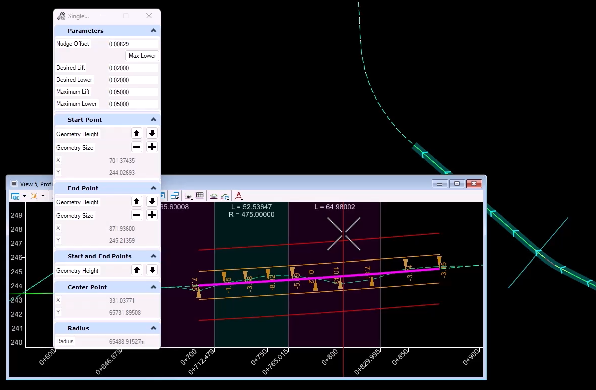

By using Vertical Single Regression tool, we can use the same workflows in vertical regression as in horizontal regression.
1. Vertical Single Regression tool
This tool includes Maximum Lift and Maximum Lower values. Maximum Lower value is a new property used to bump vertical geometry up, so no part of the crated element is lower than the survey point elevation.
2. Vertical points
Vertical points also contain the same information as horizontal regression points. You can use this information to create regression geometry that has compatible horizontal length vertical slew values.
