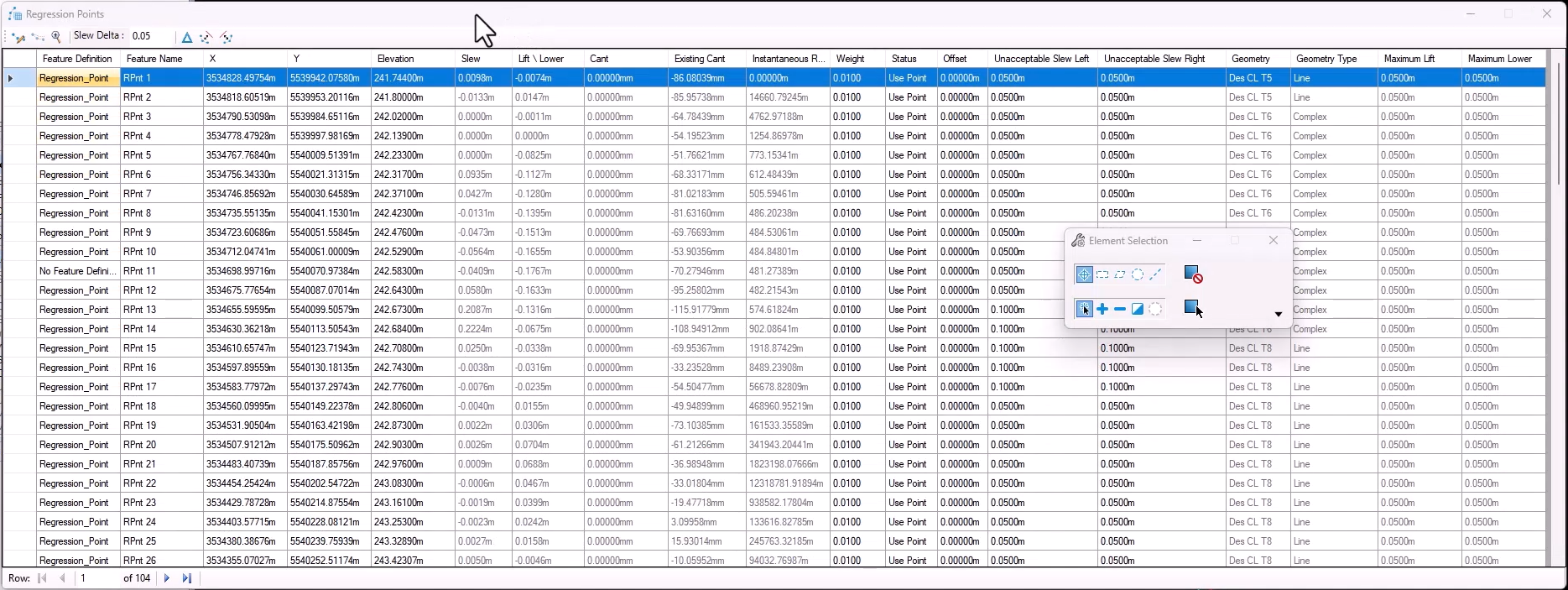

1. More information in the table
From OpenRail 2024 regression point stores more information than before, including horizontal and vertical slew values, cant, existing cant and instantaneous radius.

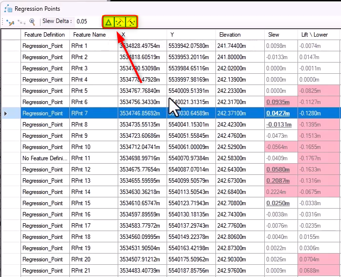

2. Point highlighting
We can highlight points based on horizontal slew, vertical lift/lower and based on slew delta.

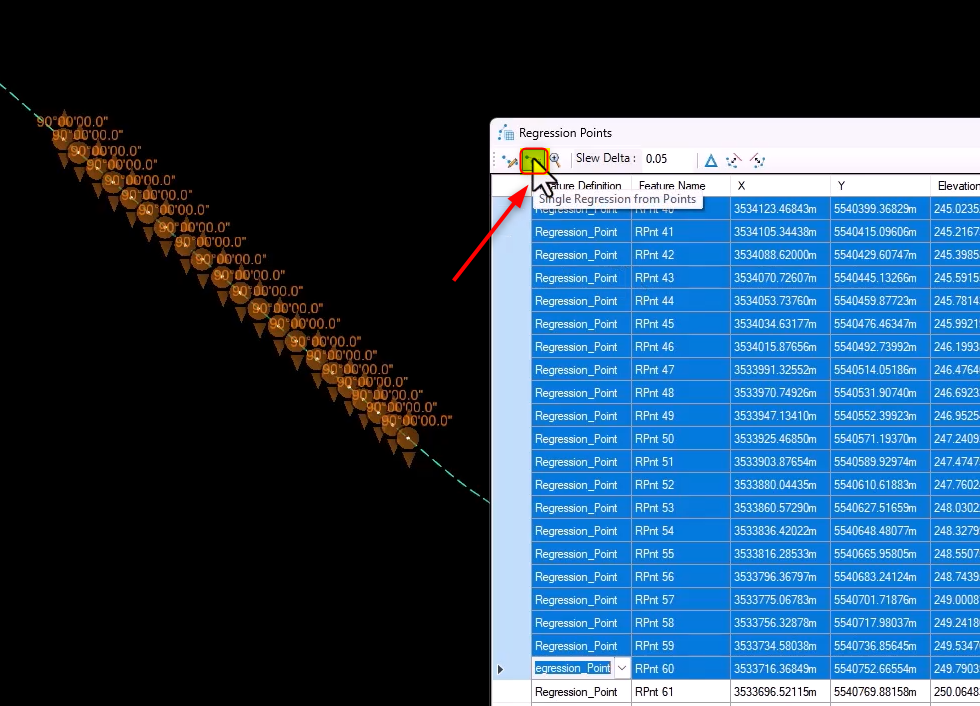

3. Creating geometry from the table
Regression Points table can also be used to create geometry by selecting points directly from the table.
