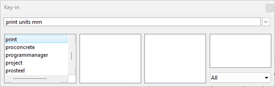

The Print Units are set to Inches. Setting the Print Units to millimeters  will show desired value.
You can change the setting using either of the following options:
