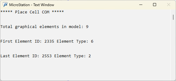

Run/Execute project
Load the project “PlaceCellFromLib.py” from the Python Editor dialog and Run/Execute the python script.
The Python script above, places two "TABLE" cells. The first cell is placed using the current active settings, while the second cell is placed with scale set to 1 and rotated 45 degrees.
Second part of the scripts scans through the graphical elements of the Active Model and gets the First and Last Element ID. This method can be used to retrieve the last placed element from the model.
