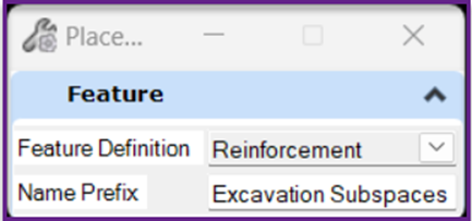

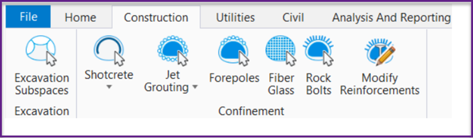

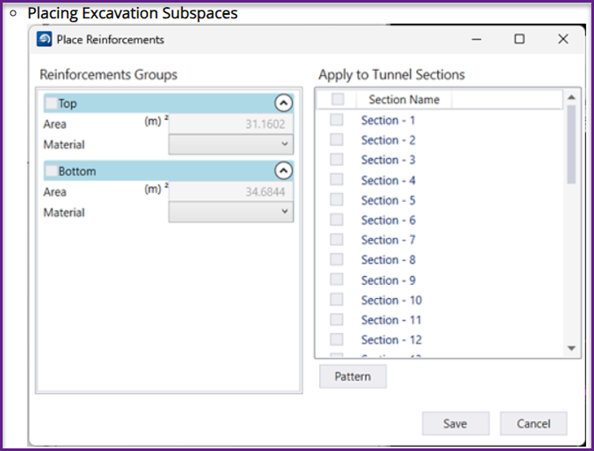

QUESTION: Where can user find the Material field which are missing in Excavation Subspaces Catalogues?
ANSWER:
The material option is not available in the catalogues anymore user must add the material option in Excavation Subspaces and Reinforcement.
There are 2 links in the first link there is a video (2nd video) which will show the procedure.
The second link which is a help file is showing step by step procedure. How to Place Excavation Subspaces and Reinforcement.
