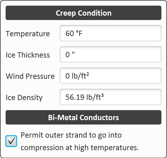

Load Settings - Creep and Bi-Metal Conductor Handling: Define the Creep Condition to be used in calculations by defining the temperature, ice thickness, and wind pressure. The Creep Condition will be remembered and retained between SPIDAsilk sessions.

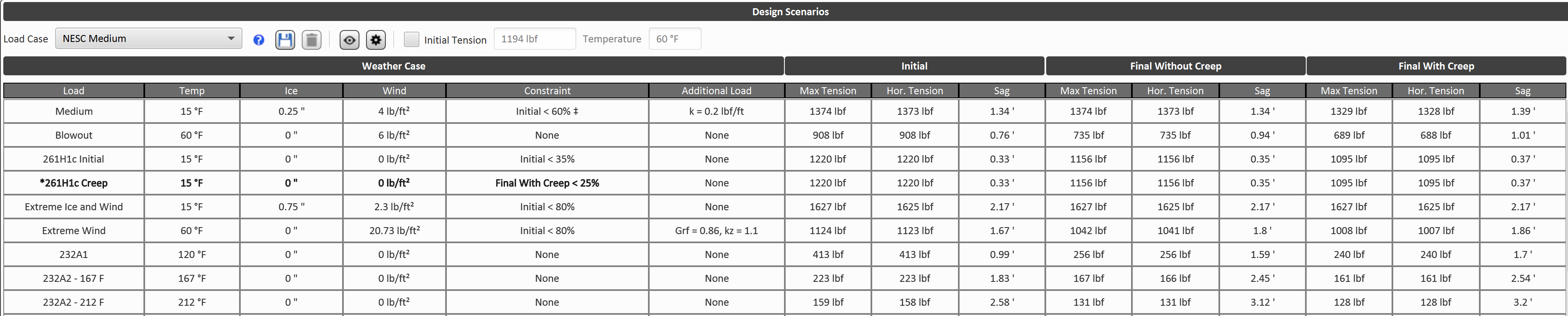

Preconfigured Load Cases
SPIDAsilk includes 10 preconfigured load cases: CSA Medium A, CSA Medium B, CSA Heavy, CSA Severe, NESC Light, NESC Medium, NESC Heavy, NESC Warm Island – Below 9000', NESC Warm Island – Above 9000', and GO95. Selecting one from the Load Case Dropdown will populate the table with individual weather cases associated with the selected safety code.

Weather Case
Load: The name of each weather case, as defined in the selected load case.
Temp: The temperature of the wire being used in calculations; this is not the ambient, or surrounding air, temperature.
Ice: The thickness of radial ice being applied.
Wind: The wind pressure or wind speed being applied. The Wind Pressure/Wind Speed button on the main toolbar controls which mode is displayed in the Weather Case table.

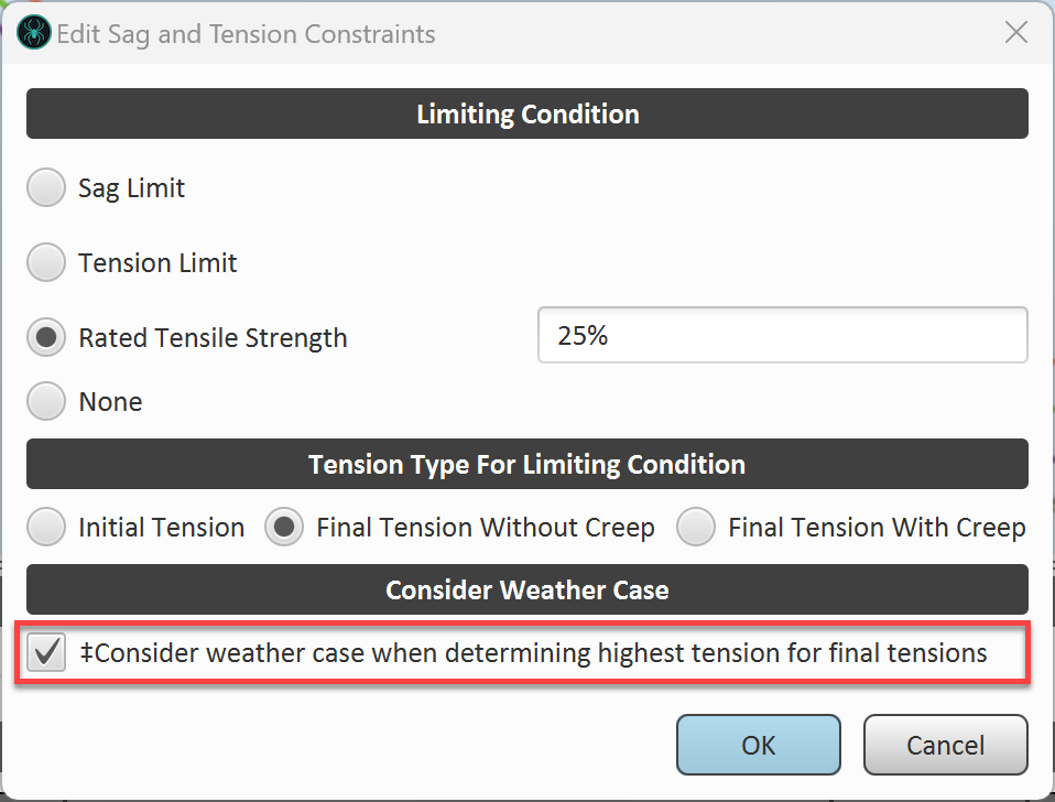

Constraint: The boundary conditions, minimum or maximum, that can be established for each weather case to reflect design parameters used to determine the wire state. The controlling constraint for a wire appears in bold font. If the "Initial Tension Checkbox" is enabled in the Design Scenario Toolbar, the constraint will be overridden.
Additional Load: Any additional loads that are being applied. This includes special logic for gust response factors and exposure factors due to the height of the wire (NESC Extreme Wind), or additional linear conductor constants (NESC Zone Loading).
Linear Force: The total force per length of the wire, including its weight, any overlashed components, and any effects of ice or wind.

Final without Creep: Tension calculated when accounting for plastic deformation due to high tension. The high tension is determined using all weather cases that are configured to be considered in the Edit Sag and Tension Constraints dialog.

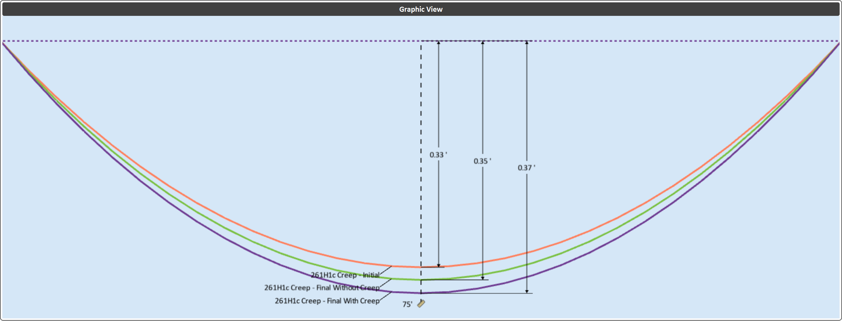

Graphic View
Users can see a visual model of the wire in Graphic View of SPIDAsilk by clicking on any weather case. If using a nonlinear stress-strain wire, there will be a catenary for each wire state (Initial, Final without Creep, and/or Final with Creep), along with sag measurements from the line of sight. Legacy wires will only show a single catenary for the elastic model.
