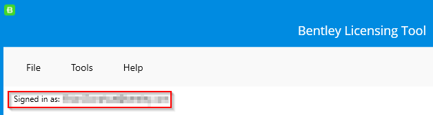

If you can sign into CONNECTION Client, this should be reflected in the Bentley licensing tool as well.
If named pipes are not functioning, the Bentley License Management Tool will not be aware that CONNECTION Client is Signed in, and will display a different message

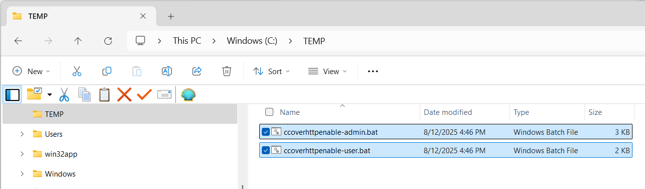

1 )  Download "ccoverhttpenable v2.zip", unzip the file to get "ccoverhttpenable-user.bat" and "ccoverhttpenable-admin.bat"

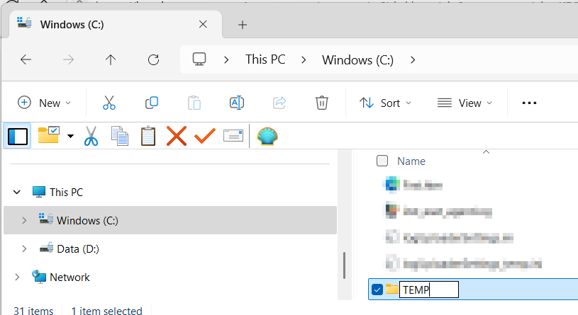

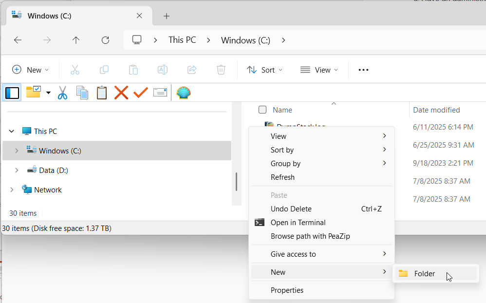

Note the directory you saved the files to, you will have to navigate to the directory in the command line. if you are unfamiliar with the Command Line, create a directory off the root of the C: drive and put the files there for ease -

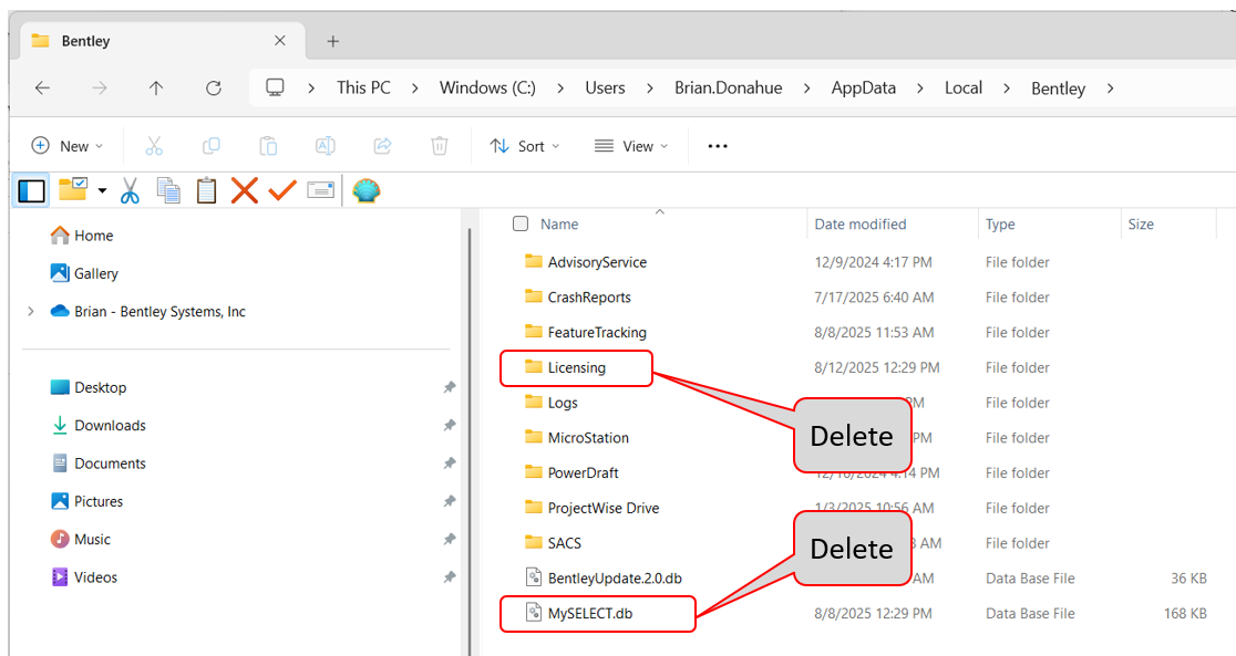

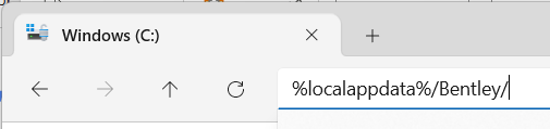

4)  Navigate to %localappdata%/Bentley/  (paste into address bar in Windows Explorer),
5)  Delete "MySELECT.db" and Delete "Licensing" folder (and all files within)

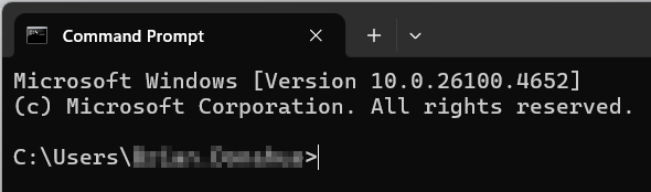

b) Sign in to windows as regular user, run CMD
c) Navigate to the directory where you saved the bat files, using CD command
CD [/D] [drive:][path]   For instance - CD C:\TEMP
d) Follow step 7e
This step needs to be repeated for every user if machine is used by multiple users

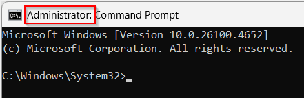

a) Run CMD as an Administrator
    1. Press the Windows key to open the Start menu
    2. Type CMD in the search bar
    3. Right-click on Command Prompt or Command Prompt (Admin)
    4. Select Run as administrator
    5. Click Yes if the Windows 10 User Account Control prompt appears
b) Navigate to the directory where you saved the bat files, using CD command
    1. CD [/D] [drive:][path]   For instance - CD C:\TEMP
c) Run Admin  script in Admin CMD ccoverhttpenable-admin.bat <space>1 <enter> -  "ccoverhttpenable-admin.bat 1" (leave off the quotes)

d) Close Admin CMD window. Open CMD again, this time as a non-Administrator
e) Navigate to the directory where you saved the bat files, using CD command
f) Run User script in CMD ccoverhttpenable-user.bat <space>1 <enter> -  "ccoverhttpenable-user.bat 1" (leave off the quotes)
    1. Note the number controls the batch file, the "1" tells it to make changes,  a "0" tells it to undo changes

9)  Open Bentley License Tool, verify that Bentley License Tool has username displayed in upper left corner. If name doesn’t appear in Bentley License Tool , run CONNECTION  Client as Admin and try again.
