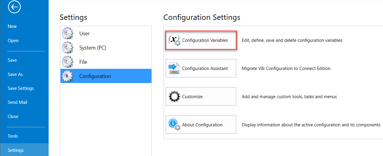

1) Pick File>Settings>Configuration>Configuration Variables.

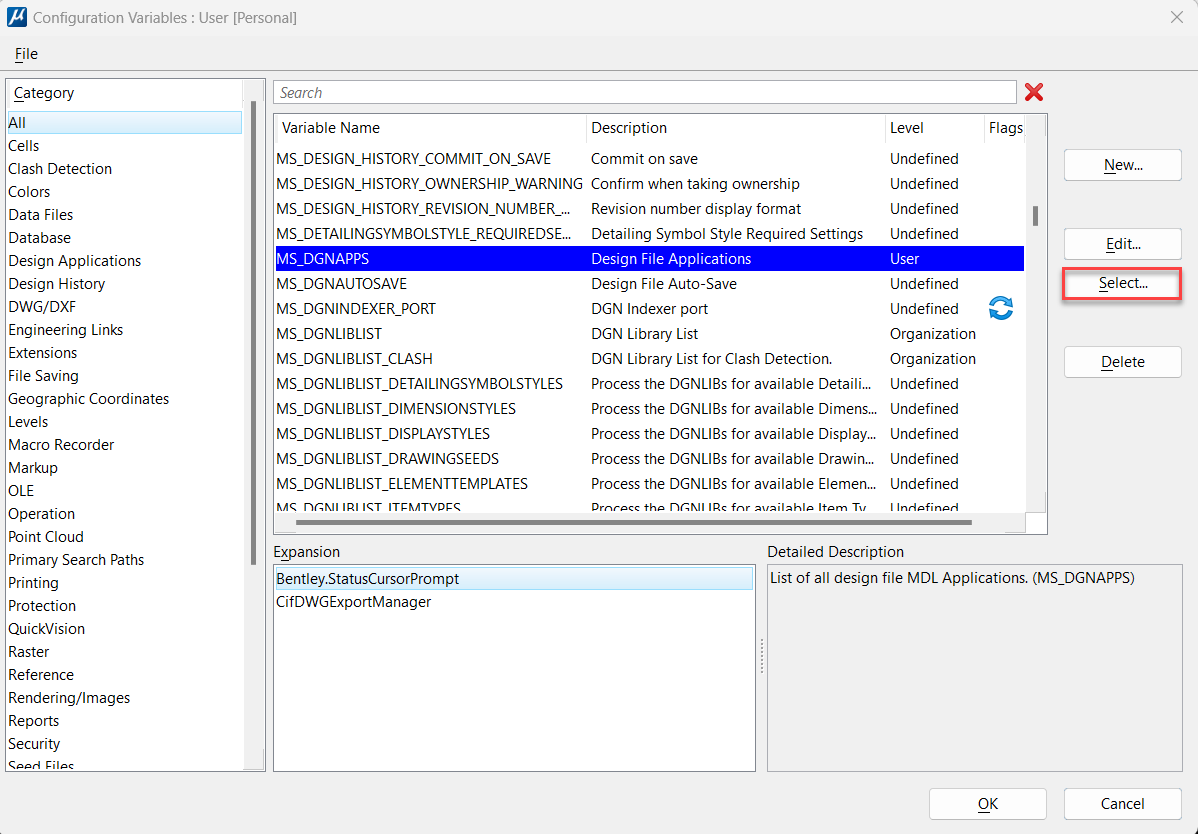

2) Pick the MS_DGNAPPS variable and press the Select button.

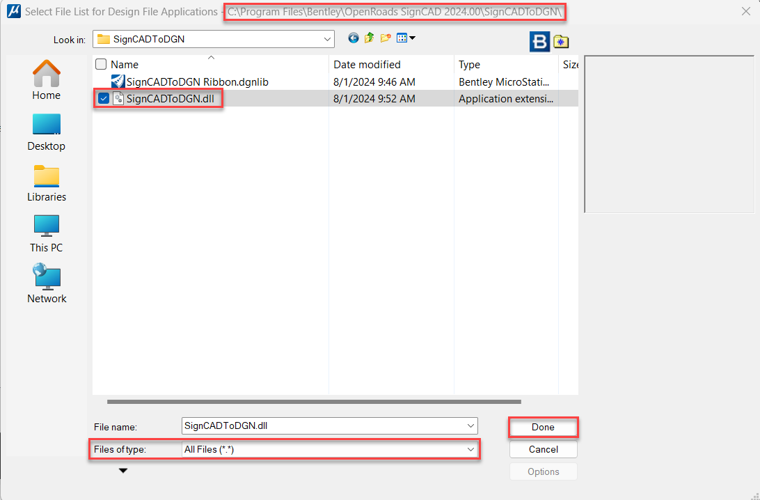

3) Browse to the C:\Program Files\Bentley\OpenRoads SignCAD 2024.00\SignCADToDGN folder. Set the Files of type to All Files, select the SignCADToDGN.dll file and press Done.

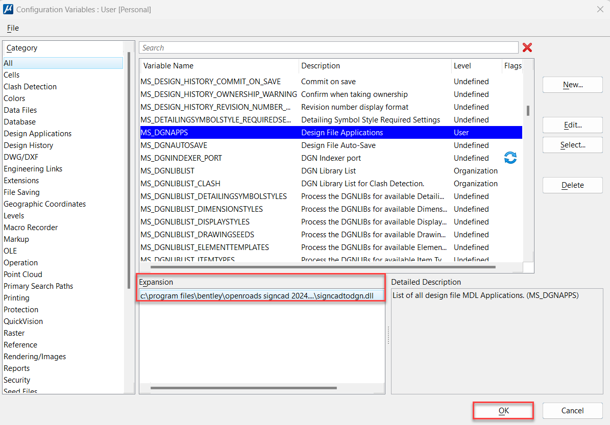

4) The SignCADTODGN.dll path will now display under the MS_DGNAPPS Expansion. Press OK.

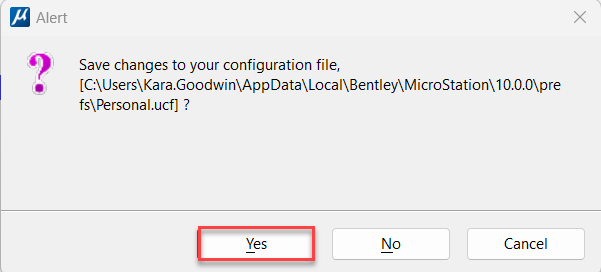

5) Press Yes to the Alert message.
