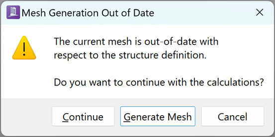

Generated Mesh Out-of-Date Warning
When analyzing previously saved RAM Concept models, the generated mesh out-of-date warning below may have been issued in cases where the mesh was current with the structure definition.
