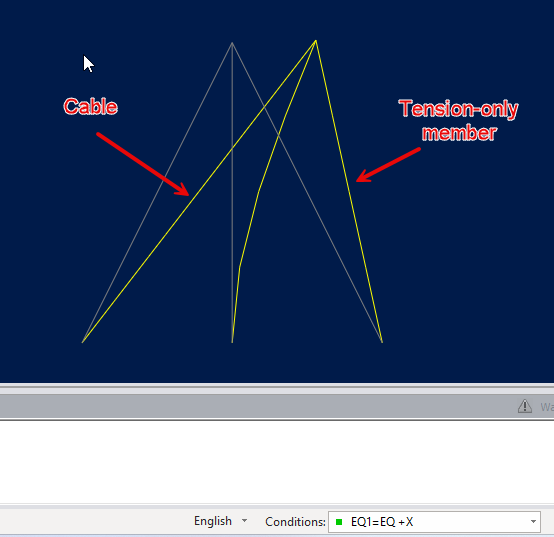

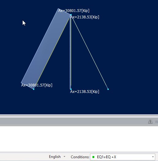

3. Expanded Analysis Results for Cable Members: The analysis capabilities for cable members have been enhanced to include response spectrum, modal analysis, and buckling analysis. Cable members now provide detailed analysis results across all available advanced analysis options in RAM Elements, offering more comprehensive insights into their behavior.
Figure 3. Cable results for a model analysis showing axial values only when in tension
