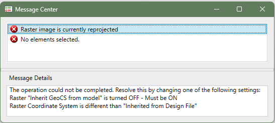

Pursuing this approach, we must also consider that Raster Manager will prevent modification of raster attachments.
Attempting to do so will result in the inability to complete the move operation and may result in the message:
Raster image is currently reprojected
The operation could not be completed. Resolve this by changing one of the following settings:
Raster "Inherit GeoCS from model" is turned OFF - Must be ON
Raster Coordinate System is different than "Inherited from Design File"

Raster image is currently reprojected is avoided by shifting the image while Inherit GeoCS from Model  is engaged for the target image.
