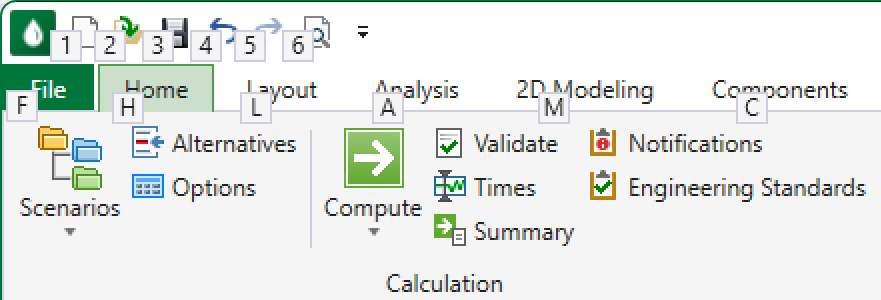

Ribbon | |
To do this | Press |
Access the ribbon | Press and release Alt |
Navigate the ribbon tabs | Left, Right, Up, Down arrows |
Open a tool/feature from the ribbon | Corresponding letter or number keys (see below) |
Enter | Execute or Open dropdown menu for selected tool |

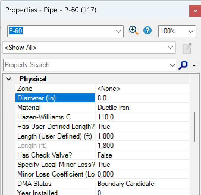

When using the Properties window (Property Grid), Tab and Shift+Tab can be used to switch focus between cells and the Up and Down arrow keys can be used move between properties (rows in the grid)
When the field name is selected (left side cell) you can immediately begin typing to overwrite the value, or use CTRL+V to paste or CTRL+C to copy the value.
