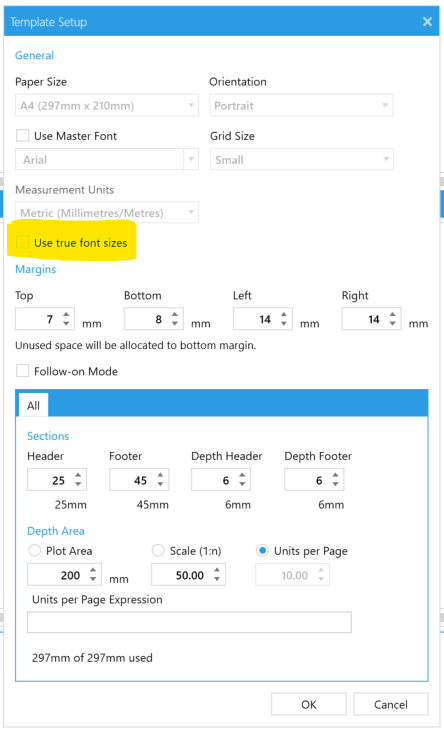

From v10.0.1.2331 (4th November 2024) of Template Studio, a new option for 'Use true font sizes' has become available.
This option has been introduced to resolve an issue where certain template objects would show font sizes incorrectly. These include; Bar Chart, Description Bar, Graph, Image Grid, Site Plan Legend, Table and Vertical Scale.
Before this option was introduced, and indeed if the option is left unchecked, a different method for calculating font sizes was used in these items. This usually led to the fonts in these items appearing larger than fonts used elsewhere at the same size.
This option can be left unchecked as to not effect existing templates, alternatively it can be checked for new and existing templates to enforce the sizes to be the same. Note that this may need for further edits to your templates to ensure sizes are correct after saving.
Existing templates that do not have this setting checked will not change from their existing behaviour.
