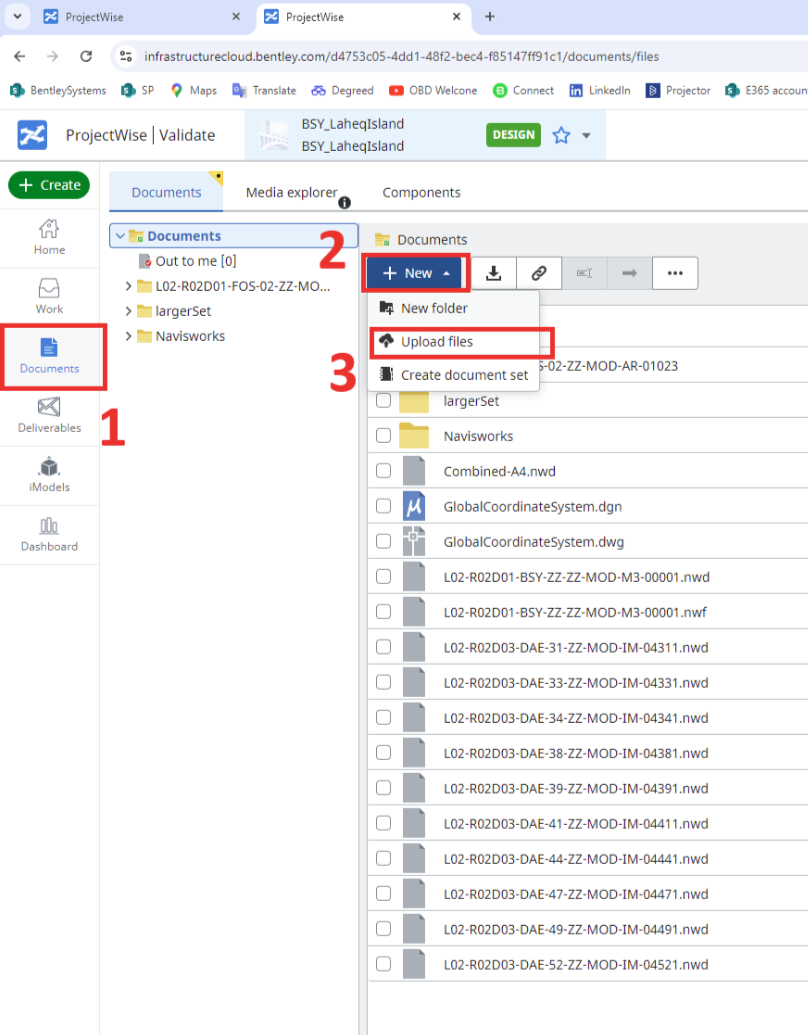

1. Go to Bentley Infrastructure Cloud (Powered by iTwin) https://infrastructurecloud.bentley.com/
2. Upload the RVT file to the documents in the Infrastructure Cloud
3. Click “models” and create a new model
4. Point the new model to the RVT file already uploaded to the Infrastructure Cloud
5. Click “iModels” on the left > Create iModel > iModel > give it a name > Add files from > design files > select what you uploaded > point to the file that contains the geocoordination data (if applicable) > next > give connection name > done > sync now
Synchronization may take a while to process. Once it’s done, the iModel is ready.
