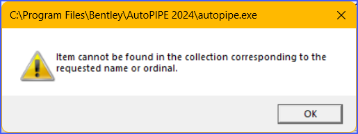

The following is displayed when exporting a file from AutoPIPE:
C:\Program Files\Bentley\AutoPIPE 2024\autopipe.exe
Item cannot be found in the collection corresponding to the requested name or ordinal.
OK
Why and how to avoid?
 Exporting Results Database (.MDB) file or other commands that rely upon this function (ex. SACS Interop) gives repeated errors for specific piping codes.
Affected Codes: B31.4(2009 onwards), B31.8, B31.4 Offshore, B31.8 Offshore , SNIP, B31.12 Hydrogen Pipelines.
Steps to reproduce:
    1.  Open AutoPIPE 24.00.01
    2.  Open any model which uses one of the above listed piping codes.
    3.  Analyze the Model
    4.  Select File > Import/Export > Export > Results Database (*.mdb)
    5. Observe that the message indicated above.
    6. Press Ok on the error message, and notice that the error message keeps popping up.
The export can be completed if all the error messages are acknowledged, but the generated database file does not have the TotalStress, TotalAllow and TotalRatio columns.
This issue has been logged under BUG 1524339 and will be fixed in a future version of the program.
This BUG 1524339 has been resolved in version 24.00.02.243.
