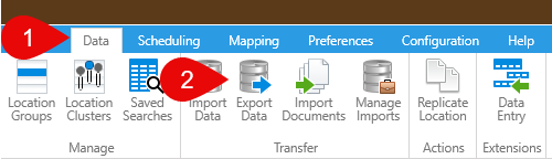

Step 1 - Export Project Information
Choose Data -> Export Data on the Project Ribbon.

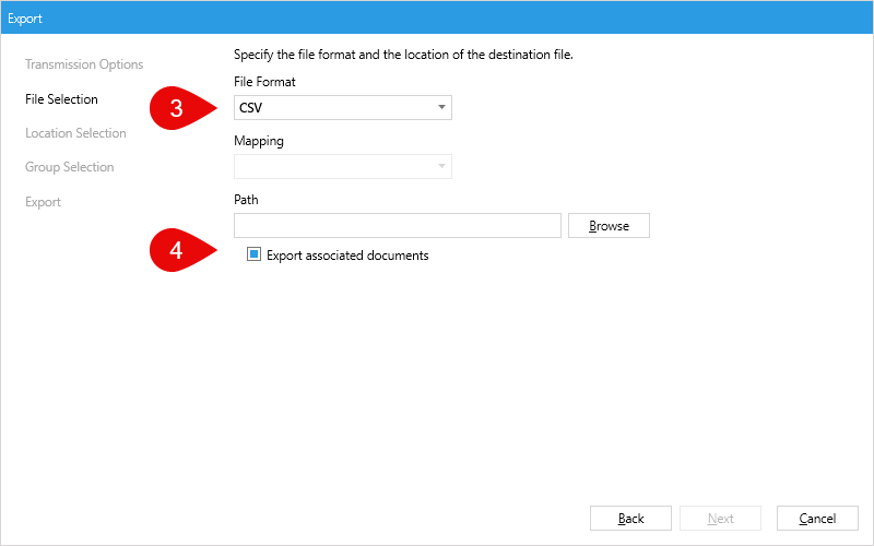

Step 2 - Export Options
Choose the desired file format (For most cases we recommend CSV for ease of importing and out-of-cloud review for North America, while for other regions AGS may be more appropriate).
Make sure to check the box "Export Associated Documents", this will include any attached photos, test certificates, logs, etc. that may be attached within OpenGround.
