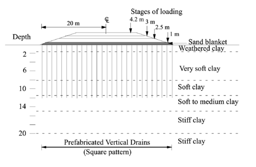

The embankment studied is the test embankment TS1 for the Second Bangkok Internal airport which has been constructed and stabilized with 12 m long PVDs installed in a square pattern using vertical FloDrain® (100 mm × 4 mm) installed with a spacing of 1.5m. The drains were installed using a mandrel (125 × 45 mm) which was continuously pushed into the soil using a static weight (in lieu of vibration) to reduce soil disturbance (smear zone) as much as possible.
The subsoil is relatively uniform, consisting of a top weathered crust (1.5 m thick) overlying a layer of soft clay approximately 12 m thick. A stiff clay layer underlies the soft clay and extends to a depth of 20–24 m below the ground surface. During wet seasons, the area often is flooded, and the soil generally retains a very high moisture content. The subsoil variation and the vertical drain pattern at this location are shown in Figure 1. The embankment load was applied in stages. Stage 1 loading was equivalent to 18 kPa, which included a sand blanket and clay sand having a total height of 1.0 m placed over 15 days. The load in stage 2 was raised to 45 kPa (over 10 days), followed by stage 3 (up to 54 kPa over 5 days) and stage 4 (up to 75 kPa over 20 days), giving a total fill height of 4.2 m.
Cross section of an embankment with the subsoil profile
