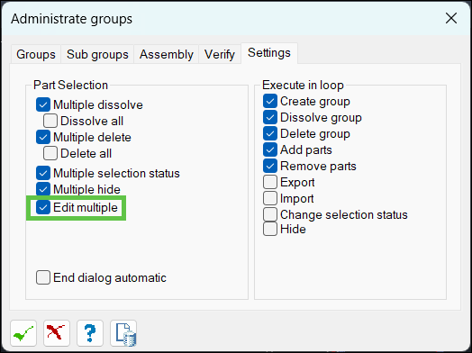

1. Open Administrate Groups tool, go to Settings tab and enable Edit Multiple option.

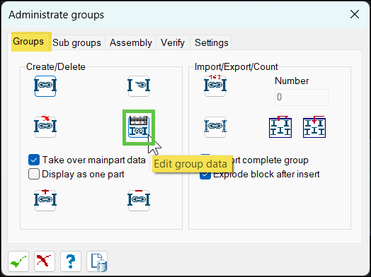

2. Go to Groups tab, select Edit Group Data button and select multiple groups for which you want to add similar notes and hit Enter.

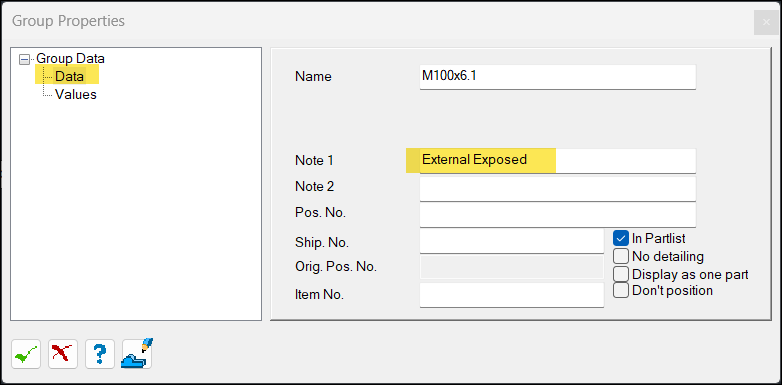

3. In Group Properties dialog, go to Data page and add your desire note here.
