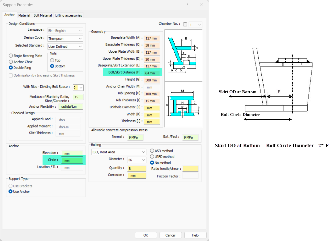

How to model cone shaped skirt in AutoPIPE Vessel?
Answer:
Refer below image for more details,

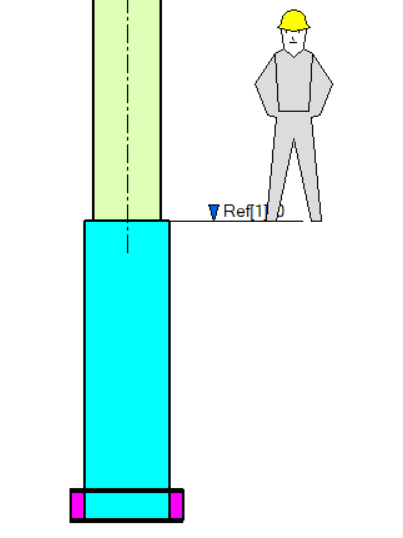

For straight skirt:

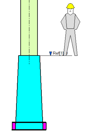

For Conical skirt:
Top Skirt OD = 762mm
Skirt OD to BCD (F) = 64mm
And we want 1000 mm skirt OD at bottom.
Then, BCD = Skirt OD + 2 * F
BCD = 1128mm
