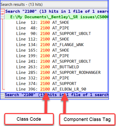

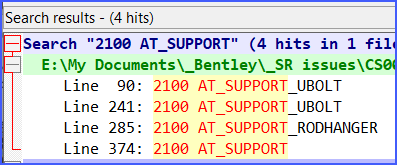

2. Search for and list all of the components being imported. Components are located on lines starting with "2100" class code.
Example:
In this example file, 13 lines starting with "2100" were found.
One can further narrow the search to a specific type of components (ex. supports) by searching for class code and Component class
Example: search for "2100 AT_SUPPORT"
In this example file, 4 lines starting with "2100 AS_Support" were found.
Question: Are there only 4 supports in this example? or are there more than 4 supports in this example file?
Answer: Take a moment and think, look at the first search... again how many supports?
There are 7 supports in this file. The narrow search did not consider component class tags that do not start with
"2100 AT_SUPPORT"
Ex: 2100 AT_SHOE,
Users must take care to really scrutinize the components list to find all the supports.

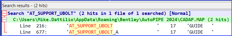

a. Identify a "support component class tag" from import PXF file, ex. "AT_SUPPORT_UBOLT".
b. Search CADAP.MAP file for "AT_SUPPORT_UBOLT"
c. Find
Question: Which line is used for mapping "AT_SUPPORT_UBOLT", Line 216 or line 677?
Answer: 216... Why?
The mapping MUST be an exact mapping, line 216 is an exact mapping, while Line 677 is not an exact mapping.

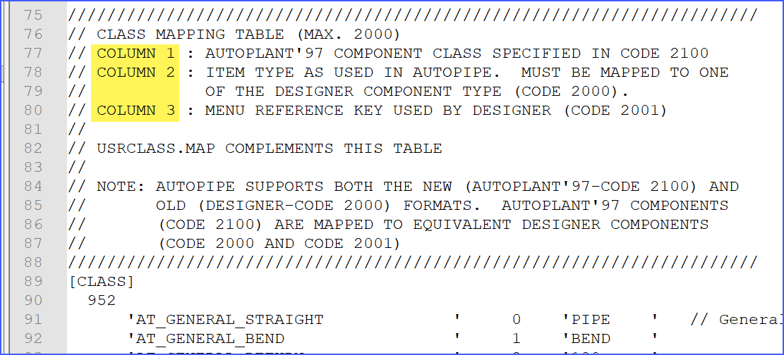

d. Scroll to the top of the section to understand the column format. Find column callout and definitions.
e. The AutoPLANT component (column 1) is mapped to an AutoPIPE component in column 2 and 3.

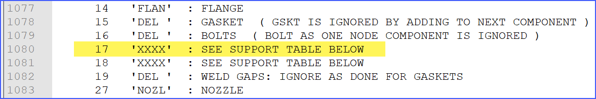

f. Search CADAP.MAP file for "COMPONENT MAPPING TABLE"

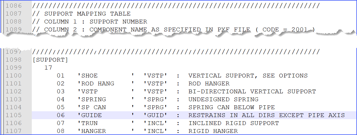

g. Again, read the details on column description, and then scroll down a few rows to Component Item Type = 17:
h. As indicated in column 3, scroll down a few more rows to the "Support Mapping Table".
i.  Recall the "Class Mapping table" above, row 216, column 4 = "GUIDE", find this designation in the "Support Mapping table", row = 1105.
j. Column 3 is defined as "COLUMN 3 : AUTOPIPE SUPPORT TYPE ( 4 CHARACTERS )".
Conclusion,
Line 90 of the imported PXF file has a component designated by "2100 = AT_SPPPORT_UBOLT"
Searching the CADAP.MAP for this "Component Class Tag" finds an exact match on line 216 - "AT_SPPPORT_UBOLT"
The "CLASS MAPPING TABLE" on line 216 designates the "Item Type" = 17 and "Menu Ref Key" = "GUIDE"
The "COMPONENT MAPPING TABLE" on line 1080 maps this component to the "Support TABLE"
The "SUPPOT MAPPING TABLE" on line 1105 maps " Menu Ref Key = "GUIDE" to "AUTOPIPE SUPPORT TYPE" = "GUID"

Question: Is every support from the example PXF file mapped in the CADAP.MAP file?
Answer: No. which one(s)?
6. All support entries, with the exception of one, are mapped in the CADAP.MAP file. The exception occurs on Line 374, where "2100 AT_SUPPORT" is not included in the CADAP.MAP file

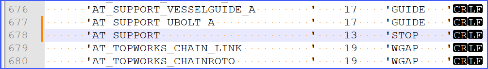

Insert a new Support mapping
a. Start by opening the CADAP.MAP

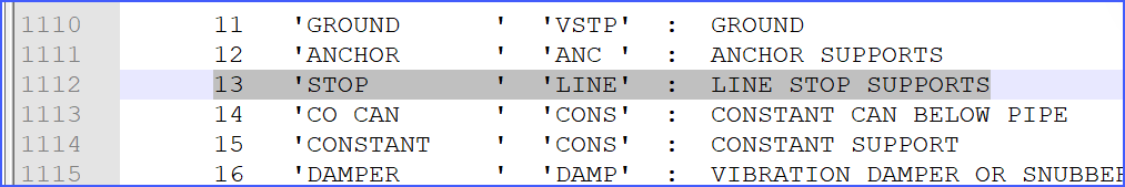

b. Scroll down to the "SUPPORT MAPPING TABLE" (lines 1087 to 1116) and decide what the support "AT_Support" will be mapped too
Ex. 13 - Stop = Line

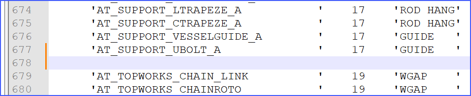

d. Next go back to the "CLASS MAPPING TABLE", on lines 90 to 1042, decide exactly what line the new mapping will be inserted on
Suggest to keep all components of the same type in the same area of the file. After reviewing the "CLASS MAPPING TABLE",
find most supports are designated with the prefix "AT_Support", which occur on lines 204 to 238, and lines 659 to 677.

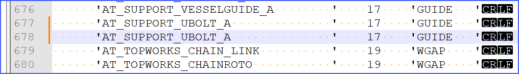

Ex.  Since there is no Line support, for no other reason the new support mapping will be added on Line 678
e. Copy the entire row 677, and paste onto line 678 (note, the text should be all aligned with the row above)
f. Enable the text editor setting to "Show all Characters"
(notes, only spaces and text are allowed, nothing else, especially tabs!)
g. While maintaining column alignment, modify the data on line 678 as needed
(Note, suggest to set editor to Overwrite mode instead of Insert mode)
