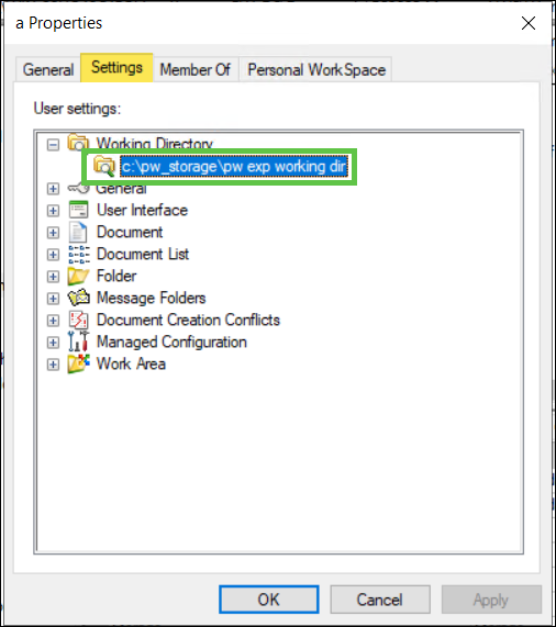

Is there a way to check in ProjectWise what /where the files are being downloaded to when downloaded from ProjectWise explorer? How do I see the destination folder?
Steps to resolve
Enter methods to resolve in this section.
1. Open ProjectWise Explorer.
2. Go to Tools > Options.
3. Go to Settings tab and expand Working Directory to know the local path where ProjectWise files are being exported.

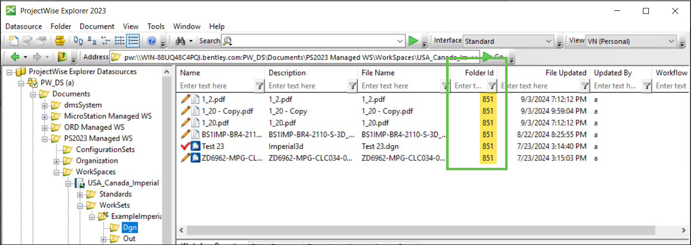

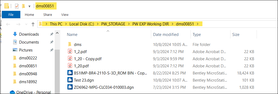

Also, you can add Folder ID column which helps you to know where the particular file(s) is stored under local DMS folders (which is inside the above highlighted Working directory).
