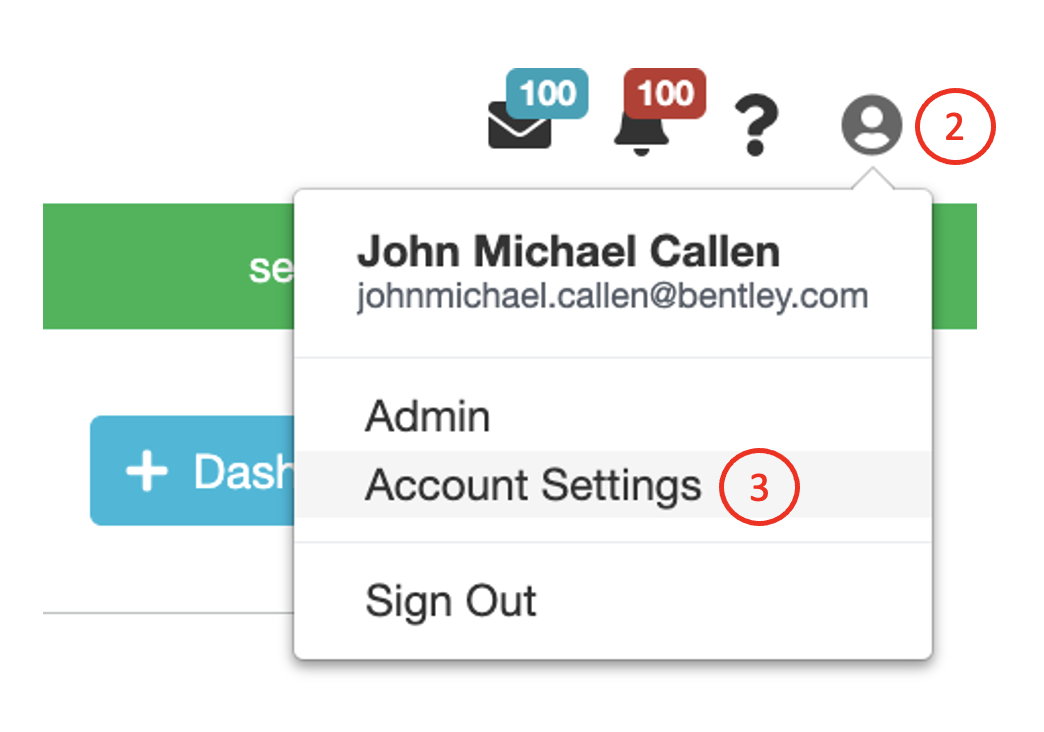

  1. Login to Sensemetrics at https://app.sensemetrics.com/.
  2. On the upper-right corner of the Sensemetrics page, click on the Manage Account icon. A selection window will appear.
  3. Click the "Account Settings" option.

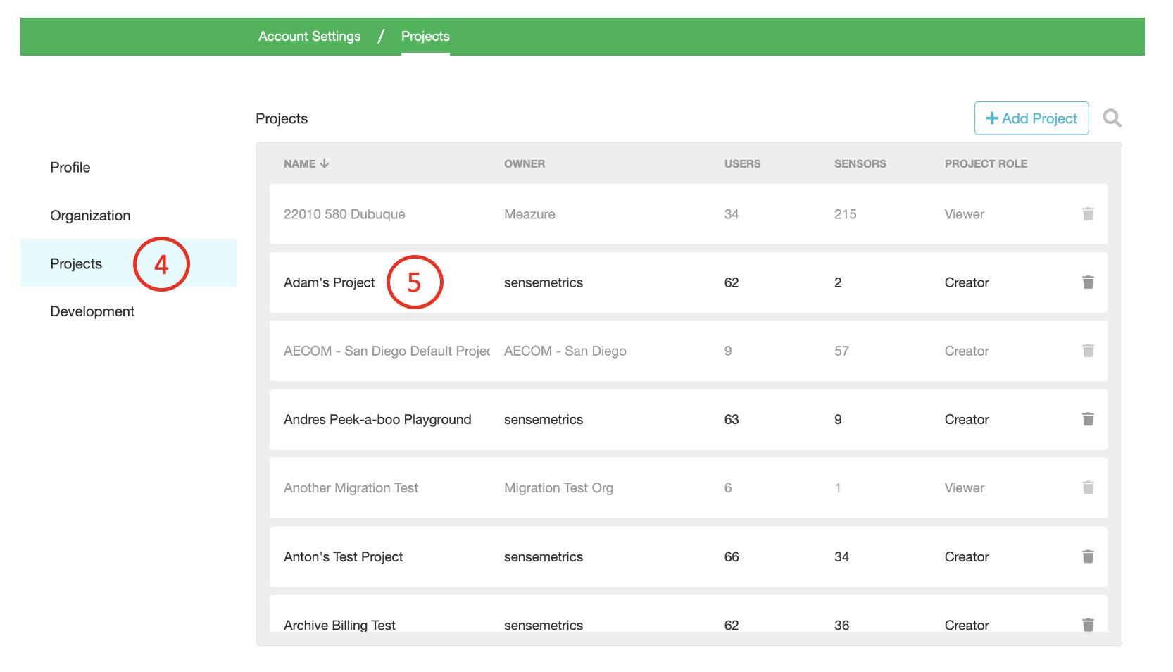

  4. In the next screen click the "Projects" button on the left sidebar list.

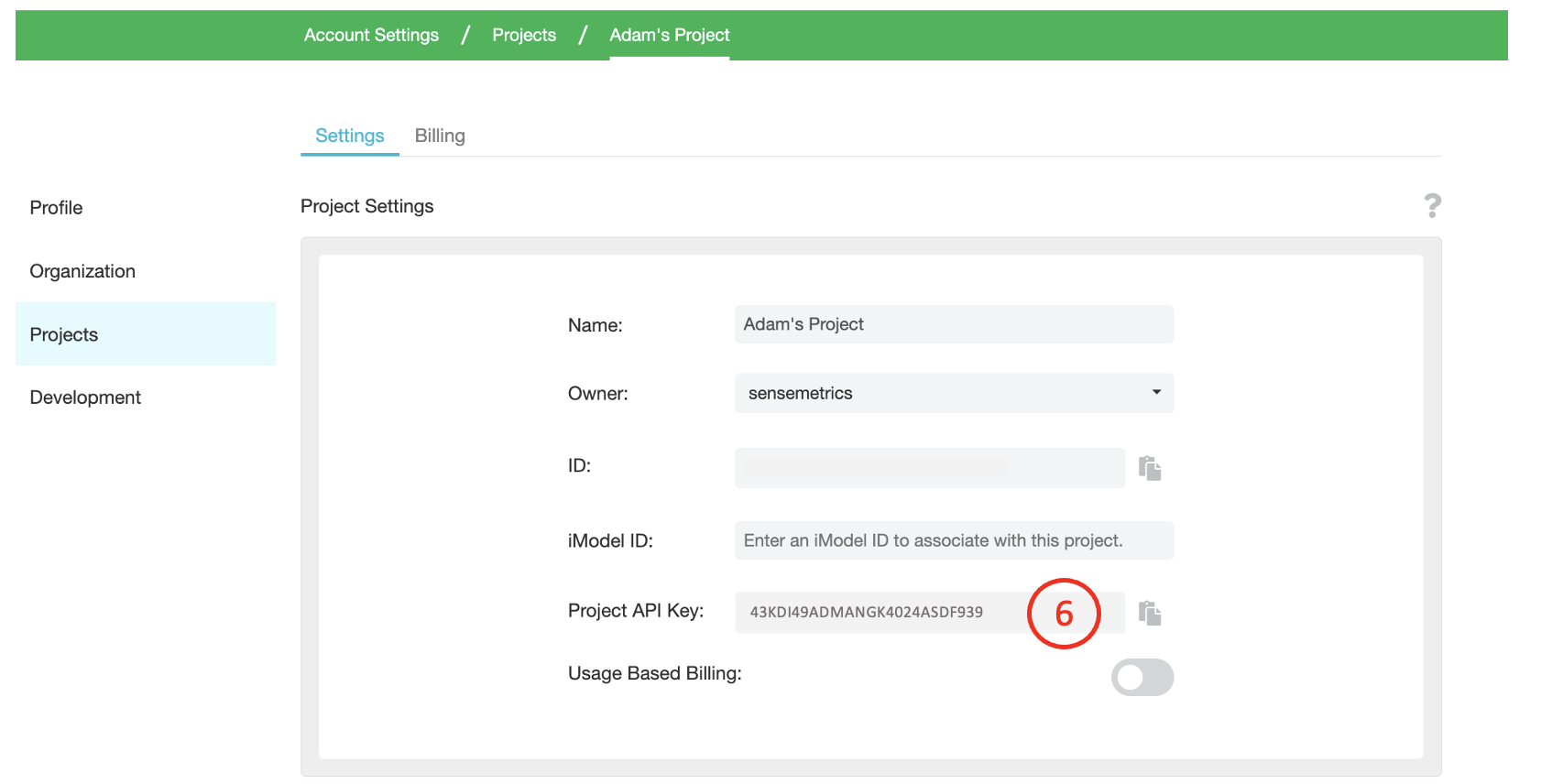

  5. Click on the name of the project to import from the Projects window that appears.
  6.  The API Key will be available within the Settings page. Highlight and copy or click the copy link button to record the API Key for use in the next steps.

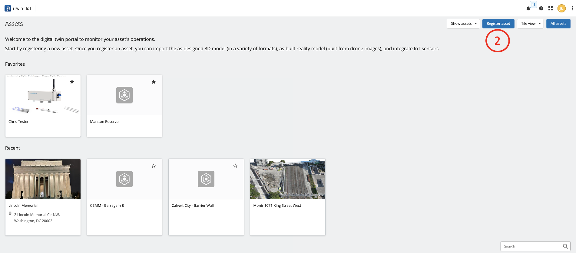

  1.  Login to https://itwiniot.bentley.com/
  2.  A blue "Register Asset" button will shortly become available in the upper right portion of the Assets landing page. Click on the button to navigate to the Asset Creation page. Note: This button may not immediately become available due to entitlement verification requirements. If this button is greyed out or unavailable, please confirm you have the proper Admin privileges then contact iTwin IoT support via a support case.

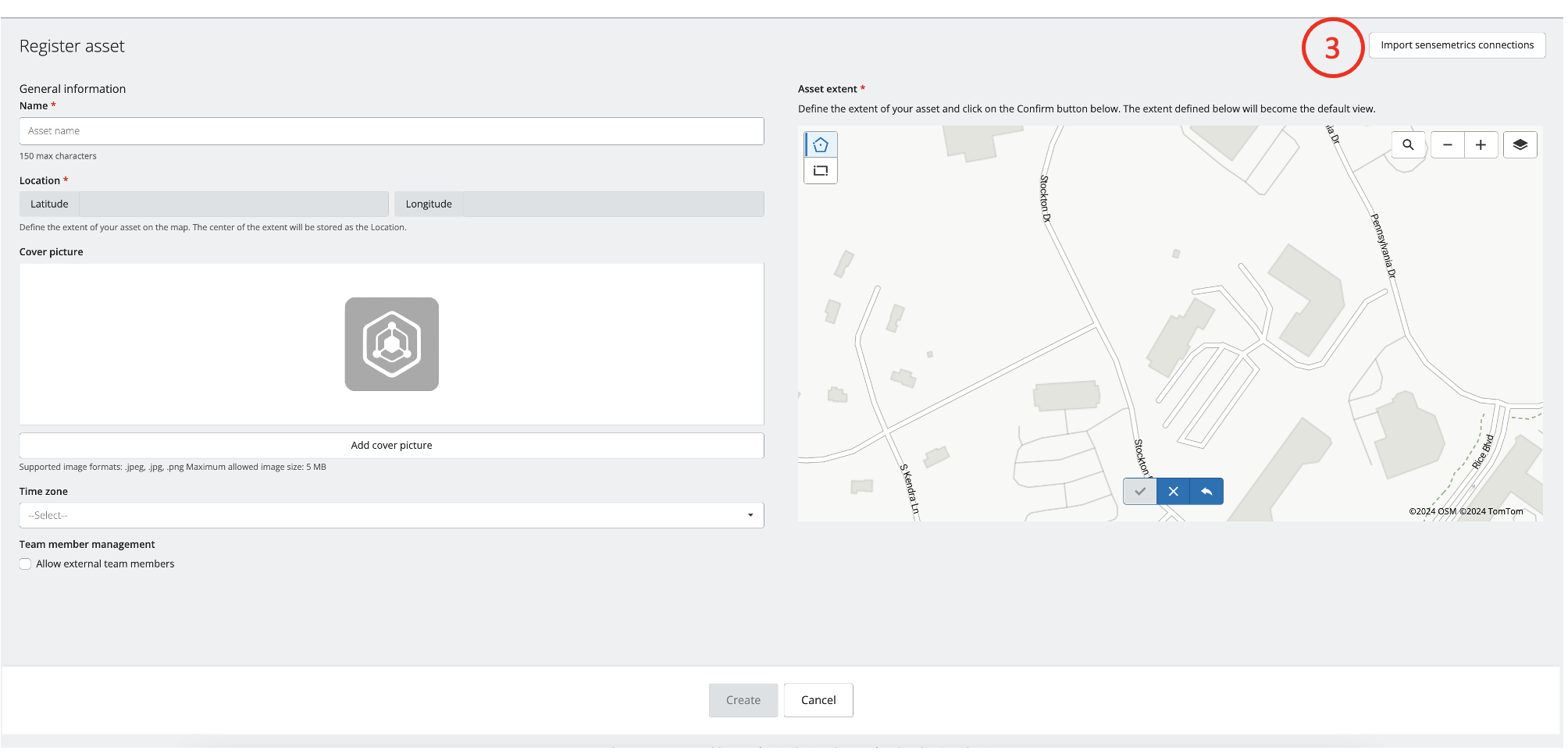

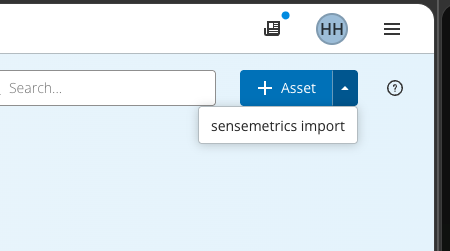

  3. You will be directed to the "Register Asset" page. On the upper right portion of the page, you will find the "Import Sensemetrics connections" button. Click this button to go to the Import page.

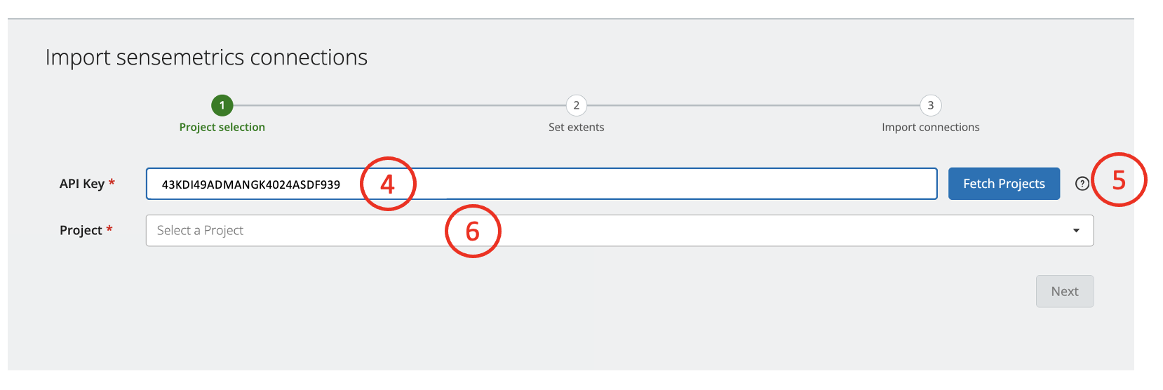

  4. The Import page will open, which looks like the below image. Begin the process by entering the API key retrieved from Sensemetrics in the previous section into the API key input tab.
  5. The "Fetch Projects" button will change colors from grey to blue. Click the button.

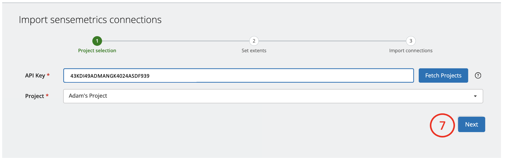

  6. Click the "Project" dropdown selector to reveal the project. If this is the correct project for Import, click the project name to select it.

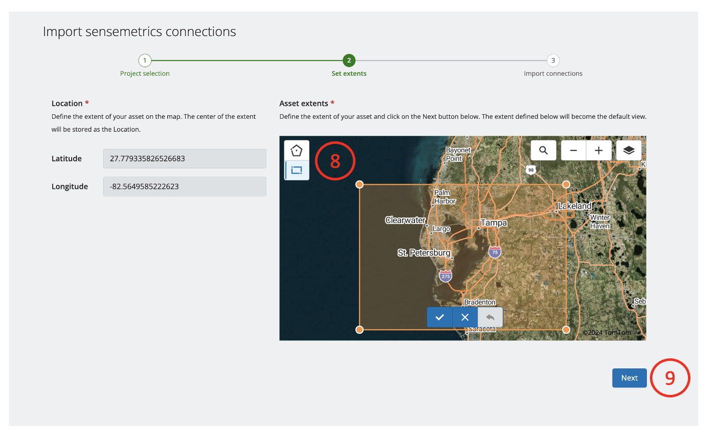

  7.  Once a project is selected, the "Next" button changes colors from grey to blue. Click the button. 8. Use the map navigation tools and the box/polygon tools to draw a box around the project. Once the polygon is drawn, click the blue checkbox button, which will populate the latitude and longitude of the selected polygon. 9. Once the extents and lat/long are configured, click the blue "Next" button at the bottom.

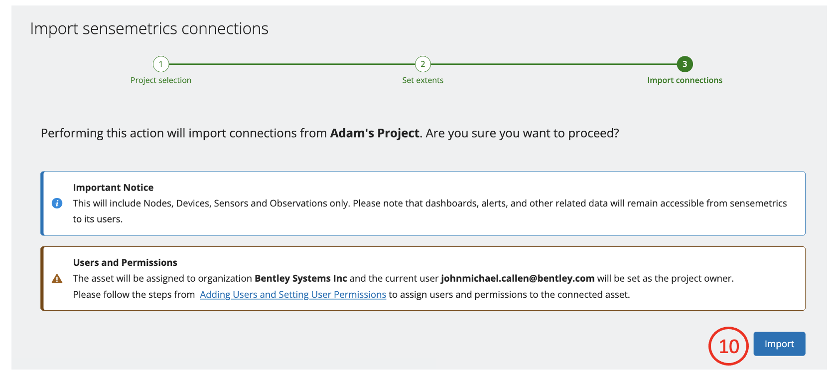

          10. The next page will provide some additional information and notices before you confirm that you would like to complete the Import. Click the blue "Import" button at the bottom if you            would to proceed.

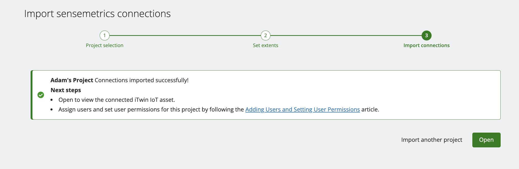

This completes the Import process! The next page will allow you to open the recently imported project or restart the process to import additional projects. All connections, devices, and sensors will be available in the iTwin IoT Connectivity page.
